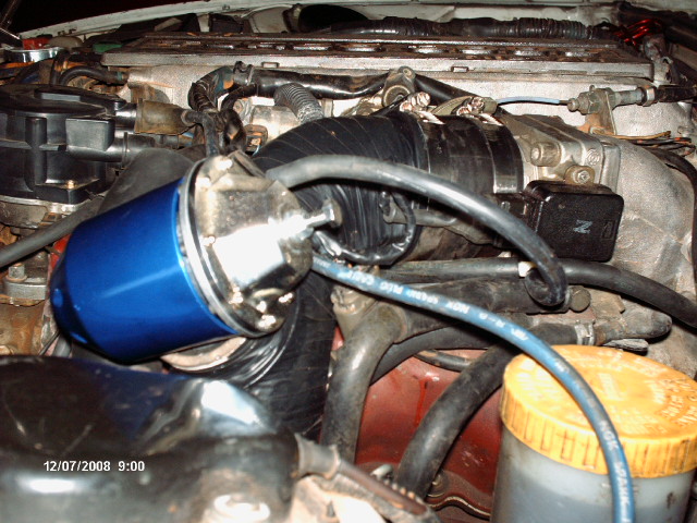

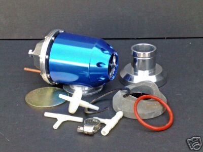

Okay, so I just got a new BOV for my z31, I welded the flange to my (j)?pipe about 3" form the TB. I hooked the vacuum line to the intake and it has 18-20 in HG at idle and no pssssst with 10psi of boost as I let off. So I was reading all over the web and on here... So, some say that the BOV should be opened at idle, some say that it should be opened only with vacuum + boost???... Then, if it's opened and high vacuum, I know that the Z will not idle right...I think I got a BOV to big for the boost I'm running...??? After looking online, a RS BOV is for 20psi boosted cars. ( could the spring inside big to big?) I pick up a "TURBO BLOW OFF VALVE SSQV + 2.5" ADAPTER UNIVERSAL-BLUE Type RS-II" I've read "How BOV's work" that did help some, but one says opened at high vacuum and the other is only with high vac + boost. No 1 answer... this has only one vacuum line to it. Blow off Valve ???-bov.jpg

instructions? whats that??? No instructions in the box... you now e-bay LOL... so I had it a part, and found the a valve insidie was not in right... danm that cheap $h!t... I just got it in and 1-2-3 it works... real short lived, less then 1 second... now I know that could be the spring...

Take a good pic of how it's mounted on your car & post it here.

So here you go... after driving today, I had to have boost of 8-10psi for 2 secs or so just to get the BOV work (super short). I read that a RS BOV is set form 12+ up to 24psi boost. This is a push pull valve, so (I think) that 20 HG vacuum + 8-24psi of boost= open... ??? and if I would of got the type R BOV, then 20HG vacuum + 3-12psi = open...??? So, do I need to find a sping that opens with less boost???
