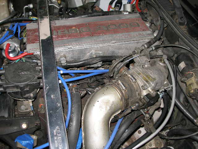

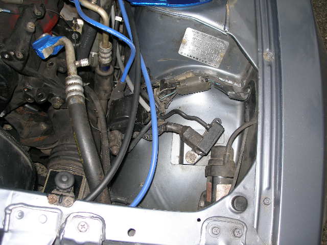

I wouldn't put much faith in the ecu codes. they have almost never helped me. test the maf per the instructiions in the fsm. you can download that from xenon's site. there is a whole bunch of junk that affects idle. i just removed it from mine. notice what is missing from mine. put a vac hose from the front of the plenum direct to the fpr. get rid of those four tubes running across the engine. reroute hoses to the carbon canister. Check your tps.

Attached Thumbnails 86 300zx wont rev past 2k rpms/limp mode-blu300-clean-b.jpg   86 300zx wont rev past 2k rpms/limp mode-blu300-clean.jpg
