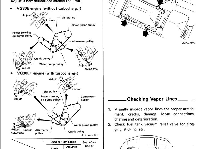

Can any one tell/show me the drive belt config for 84-86 turbo. I did the n/a turbo swap and have had that intermittant miss. I need to know where all that thick four tooth drive belt runs, I think it is power steering, alternator, idler pulley and crank pulley?? I have to start from the begining and make sure its timed right, check the t-belt etc... if the timing is right. Anybody know??

Here ya go.
