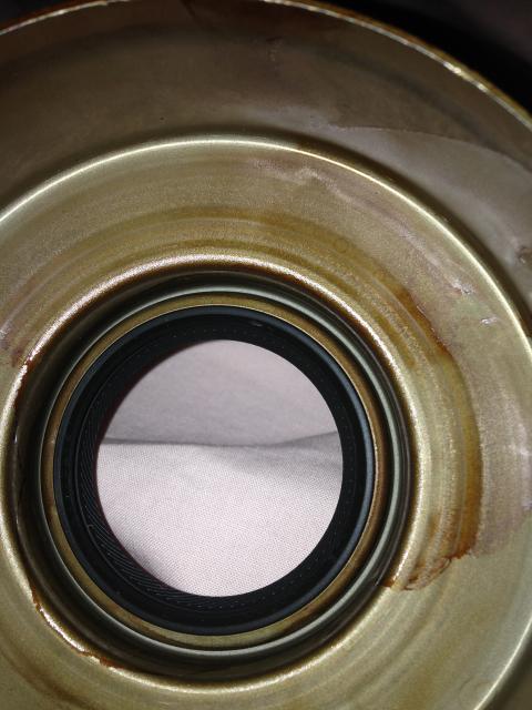

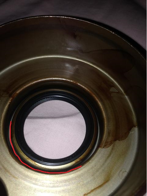

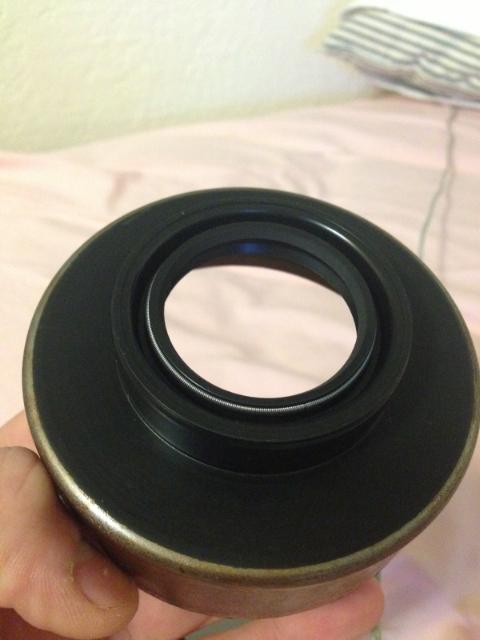

Alright i received my seal..
I guess these Borg Warner seals came attached to the dust cover because on my old FS5W71C the seal would slip inside the dust cover and this new one for the Borg looks like it was shrink wrapped around the whole thing?
I marked on a picture in red where i think a seal would go like the first transmission had, i know this new one didn't have one around that lip i marked. Before all this i ended up cutting the old one out cause i thought i needed to to replace it but i think that's how i boned myself.
