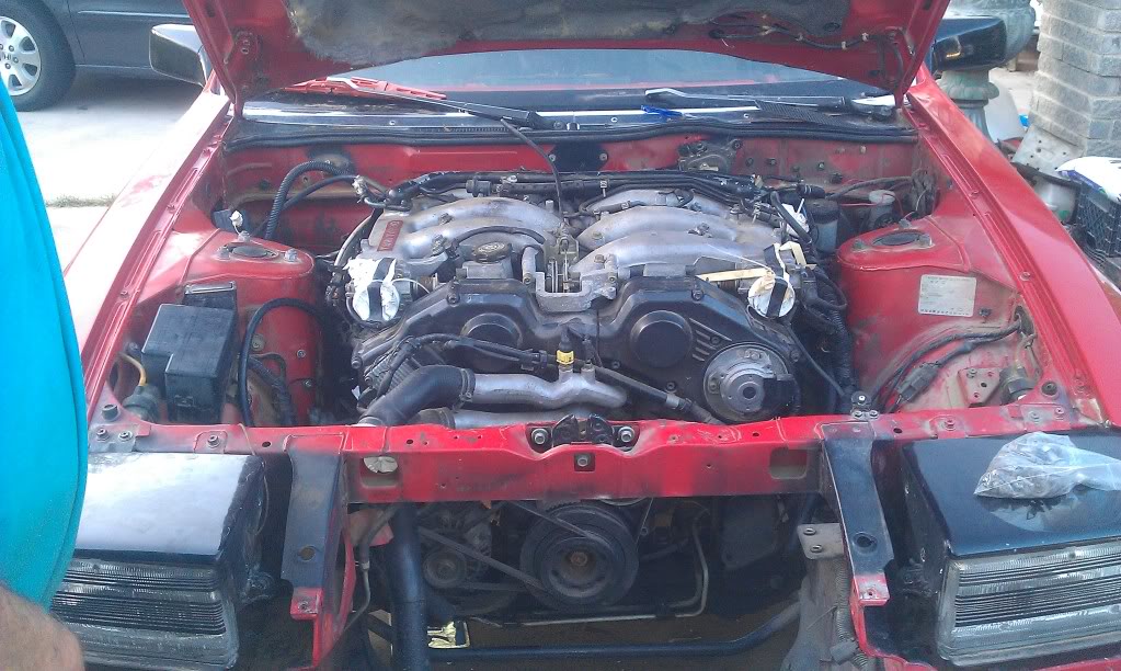

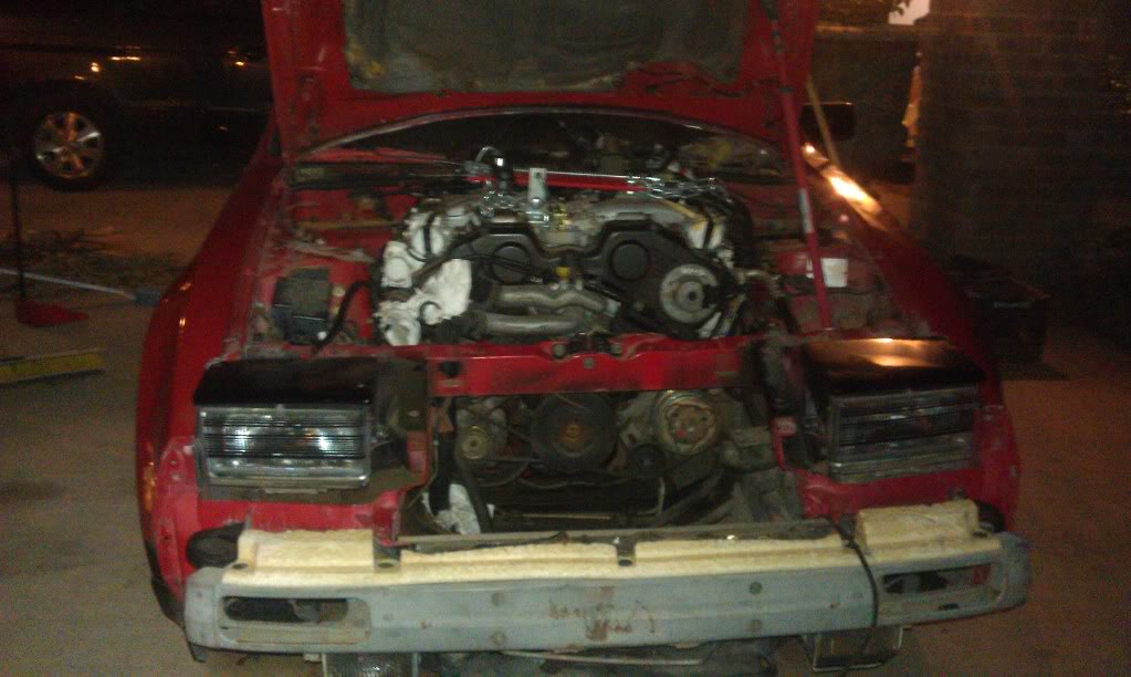

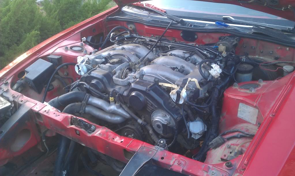

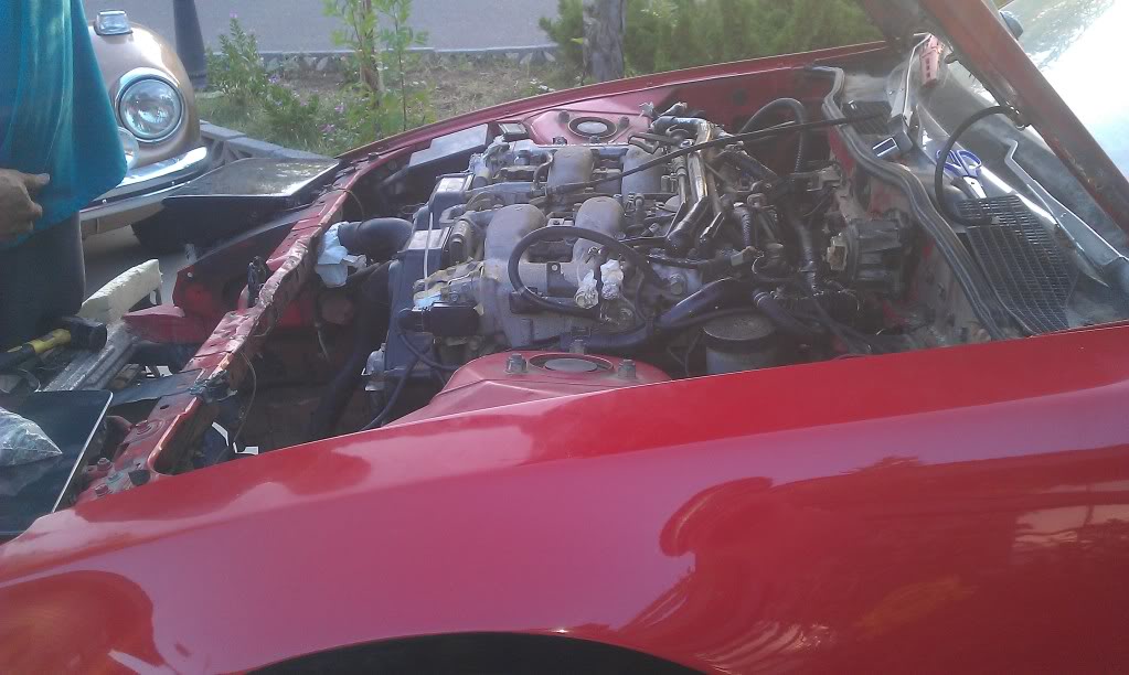

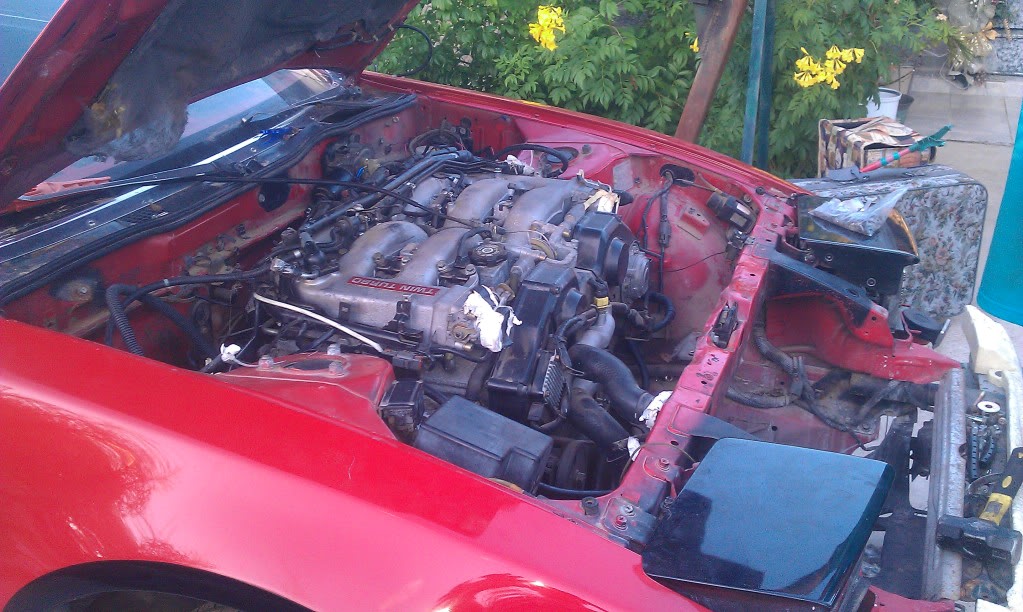

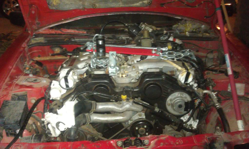

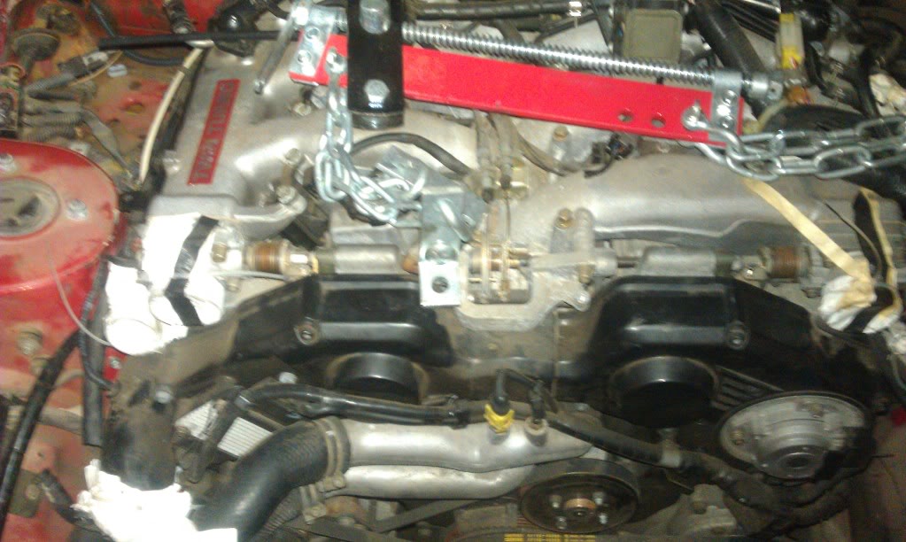

So i know a few months ago i said i was putting a dett motor in my Z31, well ive been busy with school and At work, i finally asked Friday and saturday off from work to fix her (all sundays nobody works), and this is the results for now. I still need to drop the tank tomorrow morning and rain the ooold 87 octane gasoline and get all the gunk out, then measure the tranny to the diff for my custom driveshaft. then il post more pics but for now, the heart of gold is in

That motor looks huge in that engine bay, congrats on getting it in there though, hope you get all the electrical/wiring out of the way soon so you can hear it run. Give us a taste when you get that going =P

Does the hood close? It looks like it's sitting high and really far back in the engine bay.
Did you make custom mounts or did you use the stock crossmember?
Old Jun 11, 2011 | 08:39 PM
HexaggramJDM's Avatar
Joined: Sep 2010
Posts: 137

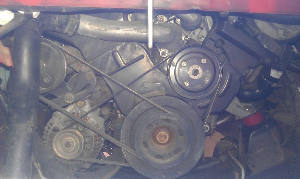

@AZ - ZBum: I used the stock crossmembers and i expanded the inserts where the mounts go "someone told me to use the Z31 mounts but i sticked to the stock Z32". I shaved off a little of the mounts to make it fit snuggly and allow clearance for the hood to close, i still need one more inch for it to close perfectly, so im instead going to get the steel hood repainted and remolded three inches so i have proper clearance and give it a little jap/muscle cross look. the pictues really dont give it Justice, since its dark, but its sitting perfectly, i can access the transmission bolts, EGR valve, hoses etc with ease and i have enough space in the front to work on the timing belt and water pump when i need to do interval replacements, you can see it in the fourth picture i think. the tranny and shifter **** fit perfectly, i didnt have to mess with that. i need a few more parts to finish, but Im almost done.

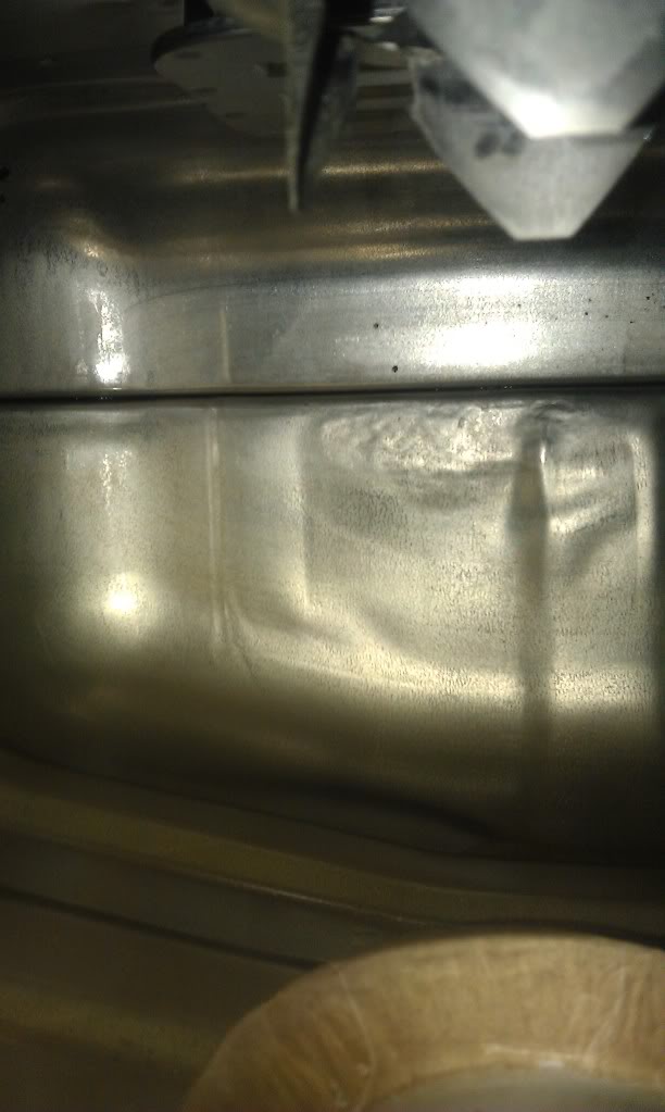

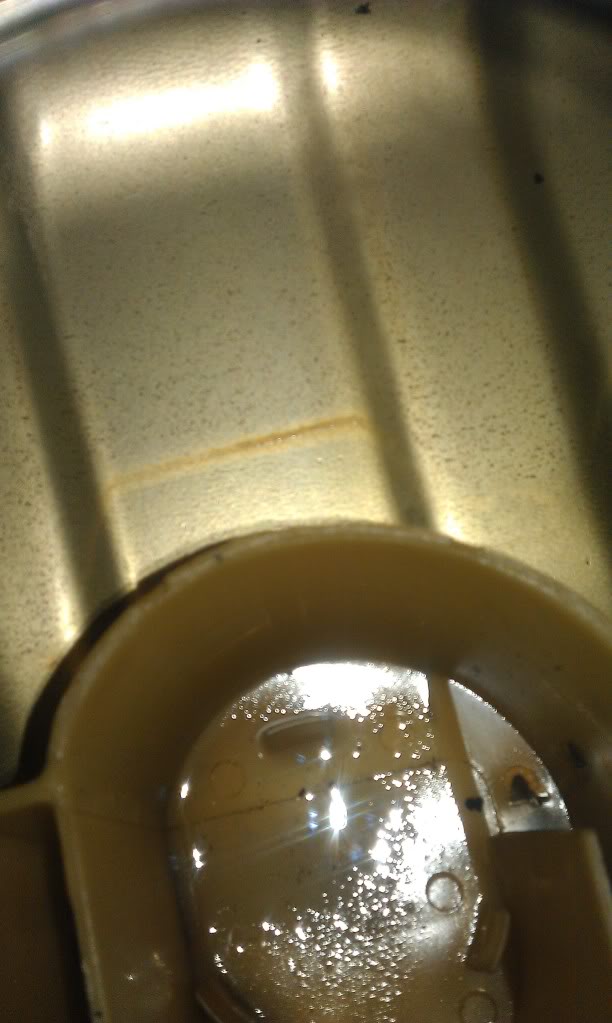

Today I took down my Gas tank, And with 2 year old Petrol i expected the worst inside the tank and I thought "oh god... here goes nothing"....I take the Tank down, my Fuel sending unit was completely destroyed and in the process Some Gas spilled in a tank, it was Dark Yellow and I was already Worried... well Damn... I did not expect this when i drained the tank... here are some pics with some of the fuel still in there.
Its Spotless inside!!!! So i just got a can of Goo off, Threw the entire bottle in there, shook it and bam.... All i need to do now is wait for the 255LPH fuel pump to arrive and buy a new sending unit.

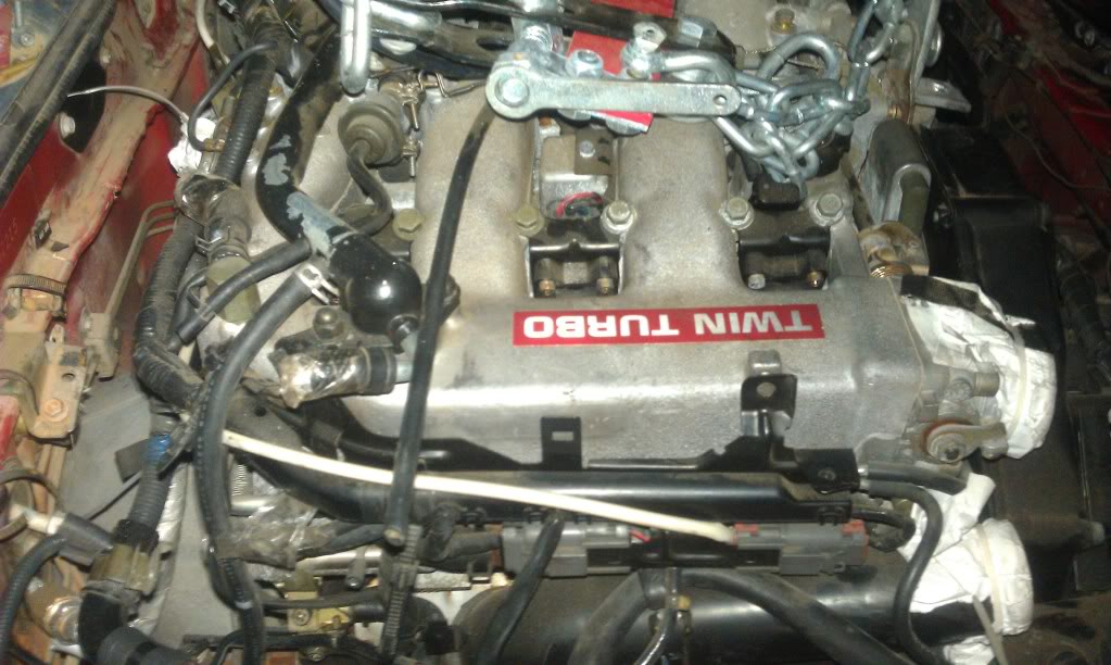

=D, heres a video i made a 2 months ago, il post another one in a few days with the intercooler pipes connected and the actual engine dressed up nicely with the SSQV's
http://www.youtube.com/watch?v=tJPwuXfAc3g

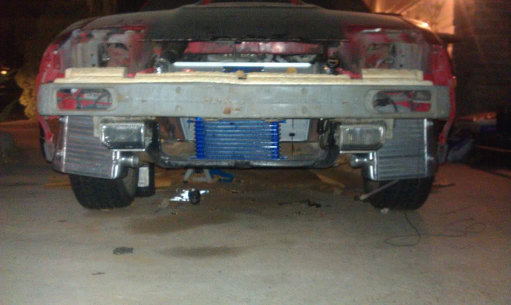

Here are some pics of the motor sat down, and my intercoolers mounted

You should look for a J30 upper water pipe, it points it more forward and would be make for less of a bend in the hose. Also don't don't forget to install a set of downpipes while your in there.
Old Sep 5, 2011 | 12:50 PM
Joined: Sep 2010
Posts: 137
well, the waterpipes are fine, the top hose needed to be custom, the bottom hose was a direct oem. And yeah, the downpipes are tricky, im taking it to a muffler shop for a full aluminum exhaust system.
Old Sep 5, 2011 | 02:33 PM
What I mean about the upper pipe, is that it will make it easier to find/route an upper hose with the J30 upper water pipe.
