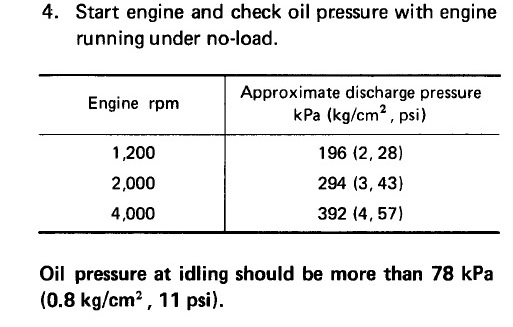

Could be a bad oil pressure sending unit (which actually screws into a port on the block casting behind the oil filter), or it could be the oil pressure regulator valve is sticking. To diagnose you need to remove the pressure sending unit and replace it with a mechanical gauge. If the pressure values on the mechanical gauge are close to those on the attached chart (from the FSM), then you do need a new pressure sending unit. If the mechanical values are still too high, get a copy of the FSM and read up on servicing the pressure regulator valve.
