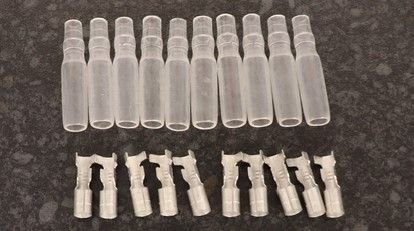

While there is a definite difference in wire that carries a digital signal (think coax cable) rather than an analog one, isn't the original goal replacing the connectors? These ceramic affairs or what ever they are made of can be found on the fuel sending unit and a whole host of connectors on my '80s era P cars (among others) and they're awful. Anyways, one possibility is to replace the female ends on the wiring harness with a bullet-style connector as pictured. Another would be to go wandering through your local junkyard.
