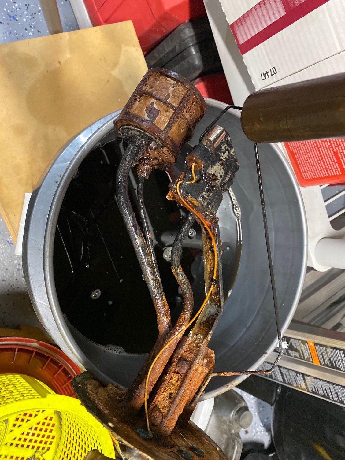

I have been searching high and low for a new fuel sending unit. Cleaned the gas tank out and got it epoxied. Now I have a nasty fuel sending unit that I don't want to reinstall. Does anyone have any idea on where to get a NEW sending unit? If not the OEM type part what would you suggest as an alternative.

I cleaned mine with CLR, detail brushes, and tender love. Reinstalled in cleaned tank and it works great. Mine looked just like yours.

Pro tip, take the plastic screen off and spray some brake cleaner in it. The pick up tube is probably clogged as well.
