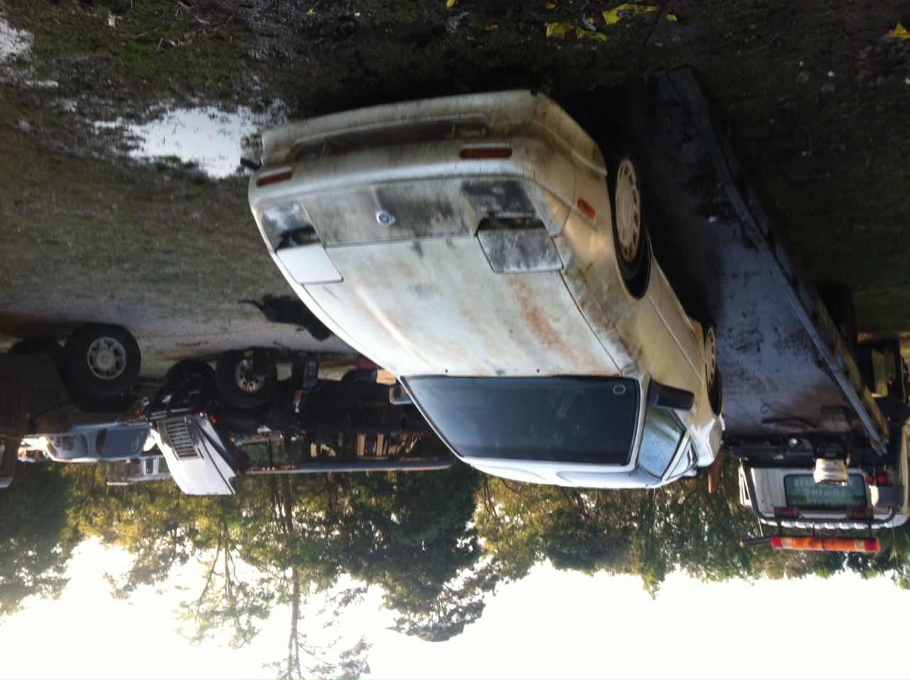

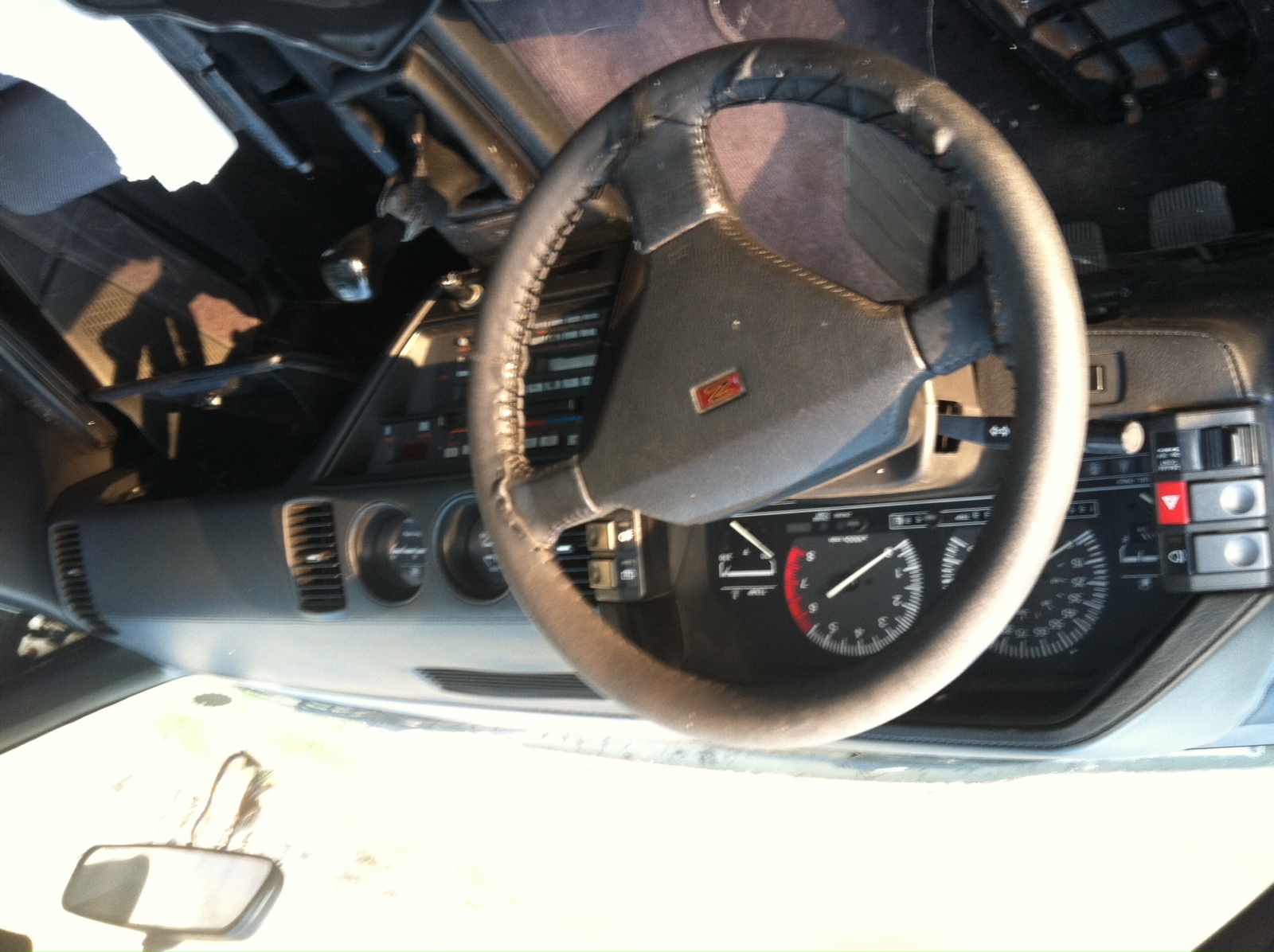

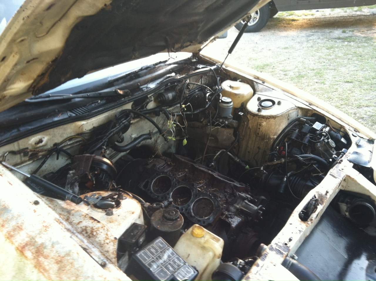

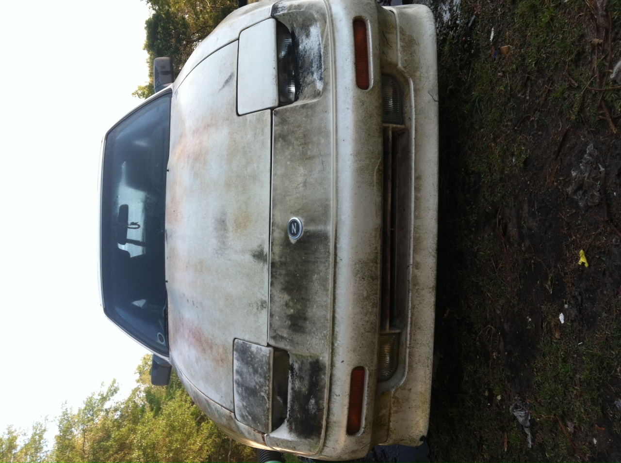

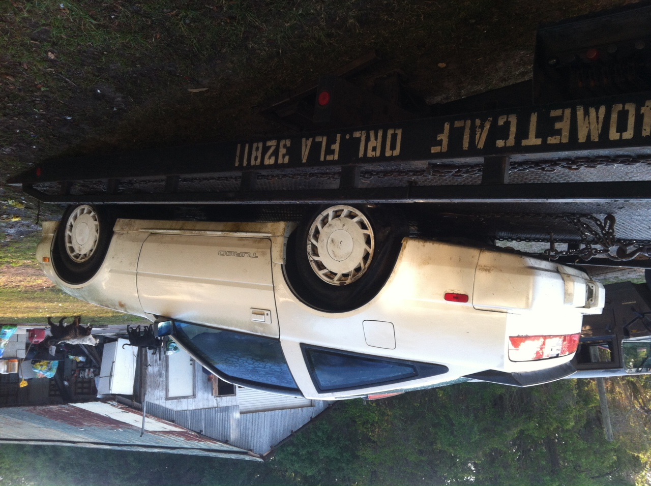

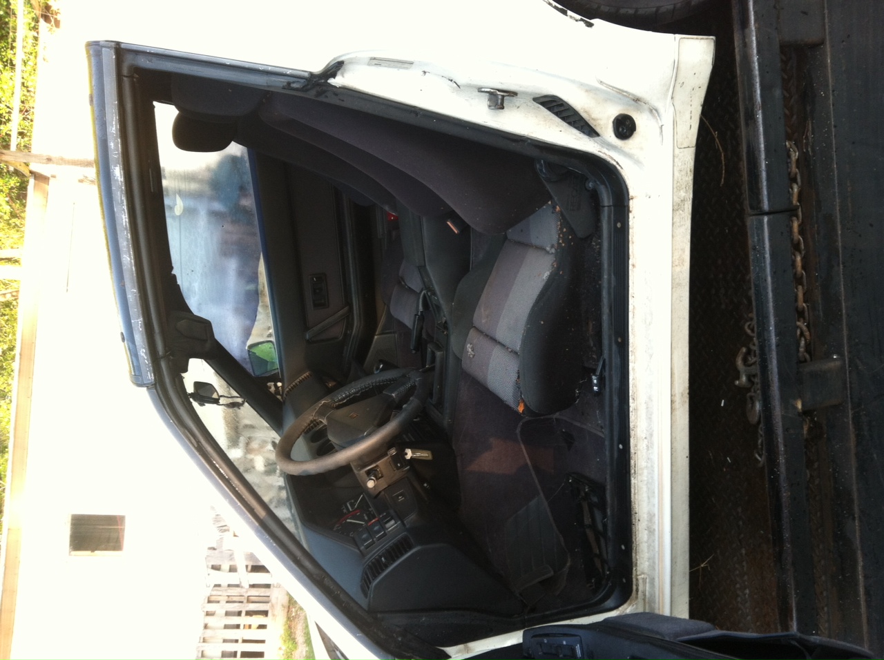

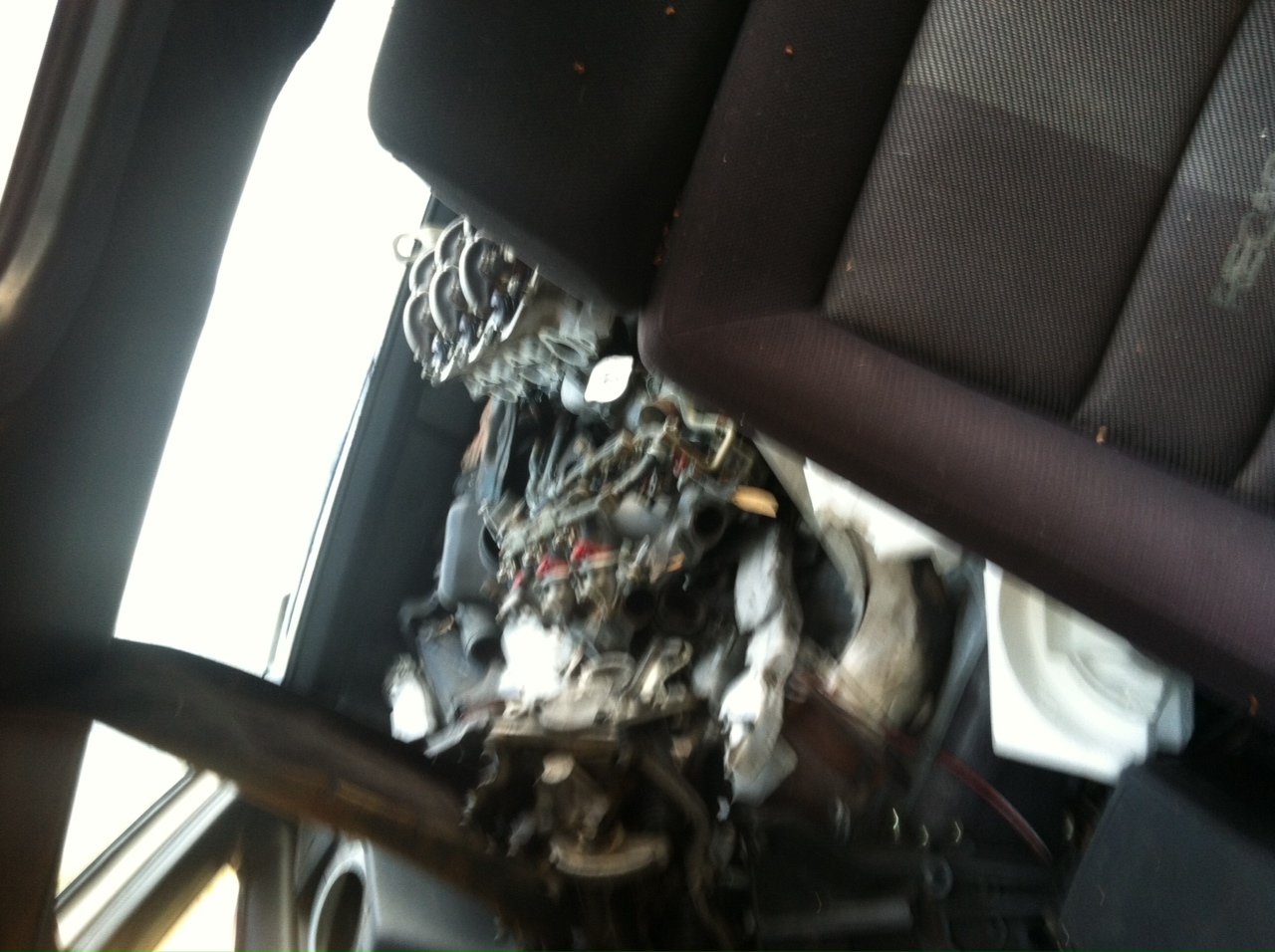

ok so when i was 7 yrs old my father passed away from cancer. but before that he had a z that he loved, he was also working on it prior to him being diagnosed.. any way my mother gave it to her sisters husband to hold onto till i became of age to drive.... long story short i havent seen the car in at least 10 years and has been outside for about 13-14 yrs..... i finally found the car after looking for 5yrs and its rough but not as bad as i thought..... my dad had the head off and the rest of the block is still mounted.......the head has been sealed inside the car and the block has been kinda uncovered theres no plastic or anything over the block but the body was its only protection....... i want to fix this car because it was my dads and thats what he would have wanted and because its a shiro and only 1002 of them were made.. heres some pics of the car.... can anyone give me some insight on what i need to do to the motor? it would really help

I'd pull the motor and take it down to a machine shop and have it cleaned up first off! After that it's just a matter of hooking everything back up once the engine is back in one piece.

thank you, thats what i was thinking.... but didnt know if there was a "easier way"..... and do you know how much somthing like that typically costs? im just trying to get a VERY rough estimate on pricing things out

Call a local shop and see how much it would be to dip and hone your block. Possibly resurface your crank and check out your bearings. Really dont know whats on the inside of that oil pan to you pull it. To dip my engine, bore it 20 with new freeze plugs was like 250. Like they said pull the engine. start taking it apart and check the bottom end to see if water or anything found its way through the engine.

no it ran perfectly fine before he took it apart... im pretty sure he was modding it..... but everything stock is still there... but i just got word that they have a totaled N/A that still runns good.... could i just use the higher comp block from that and bolt the turbo head on it?? and could i use the N/A engine harness? are they the same as the turbos?....... and sorry i didnt take the pics
The pictures are upsidedown for me as well.
The heads are the same for turbo and NA models. Just bolt the motor mounts, lower intake manifold, plenum with accessories, and driver's exhaust manifold with turbo to the NA motor and call it a day.
That car needs a serious cleaning.
