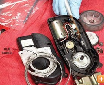

How far is up? How long is a piece of string? Now those are dumb quesions. Anyways...
1. Never underestimate the power of a Chilton or a Haynes manual.
2. In my case, the cable had broken. Once apart, you can get a new one should this be the case.
The replacement is usually comprised of a mast and cable. Available at the usual suspects. Repair instructions available here.
