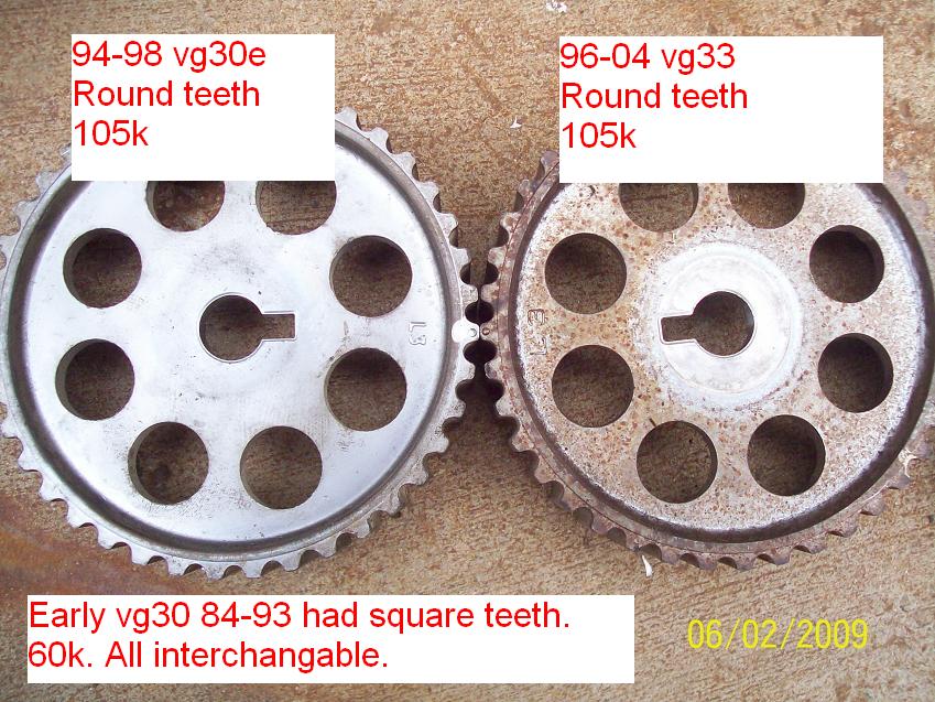

Its not necessary to change the sprockets, but one upgrade i've heard is to switch to vg33 sprockets. The belt lasts 100k miles vs 60k.

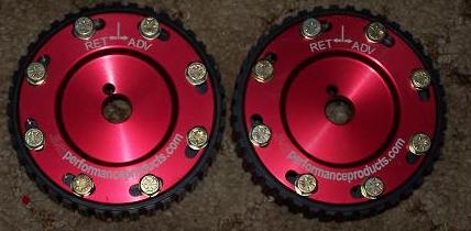

Looks like the VG30 changed to round teeth on the cam sprockets in 94, most VG33's have round teeth, like a 96 pathfinder. The belts changed also, to match the tooth profile on the sprockets (makes sense), so Ill probably change to the round toothed sprockets in another 60K and then be good for 100k per belt after that. I'm guessing the square teeth are harder on the belt and wear them down faster. Good tip to know I found this adjustable set that comes in round or square teeth, pretty cool. Z31Parts.com :: High Performance Z31 300ZX Parts
