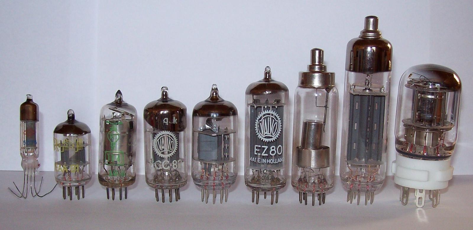

Vacuum Tubes
I know Rogerz was biting his tounge, but vacuum tubes are these old school electronic parts. Some modern amps and other goodies still use these old style parts.

not only that I have actually seen those things in working electronic devices
