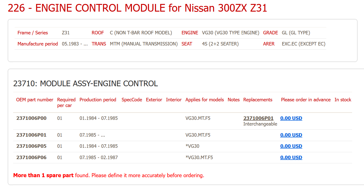

I hope this helps:
I found this at a Nissan parts Euro site.
