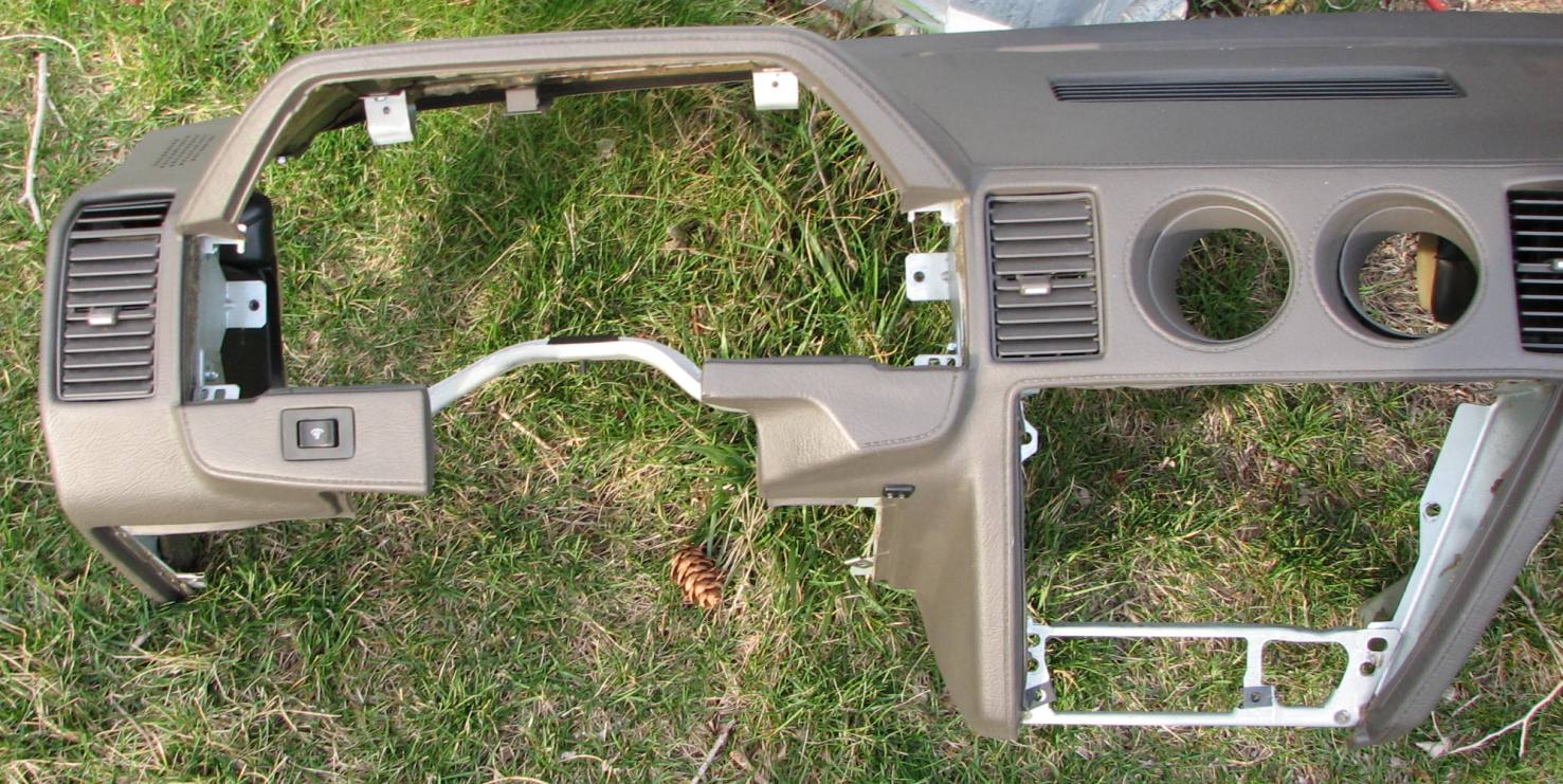

Dash
I have that exact dash in perfect condition in my shed, my car only had 85K on it when I wrecked it, was always covered and garaged, so its in pretty nice shape, I pulled the entire interior out, sadly the headliner got a black mark on it from me stacking stuff on it.
Dash
There is a bad spot, something made a grease mark, tried to clean it up, should be ok, worst case a little matching dye will cover it. I have so many parts you could use, any chance you will be vacationing in Idaho soon ? I could load You up with parts, we could even take a cutting wheel to the body and get you all the patch panels you might need, the under carriage looks new, no rust
steve
Steve has a lot of parts for our cars
300zx Parts For You webpage
When he has dashes, he is selling for 195 plus 100 shipping
The dash looks great! Nothing that a little cover up cant fix. Now... If you could figure out how much it would cost for you to ship it, we may have a deal. I'm assuming around the same price range... Which I'm not sure is worth it. A trip to Idaho is not likely, but I wont completely take it off the board.
