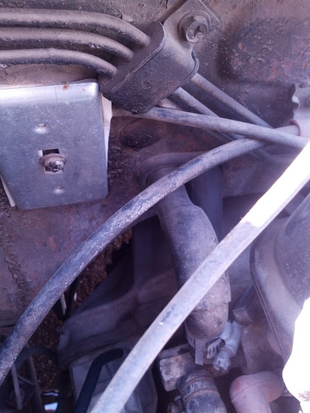

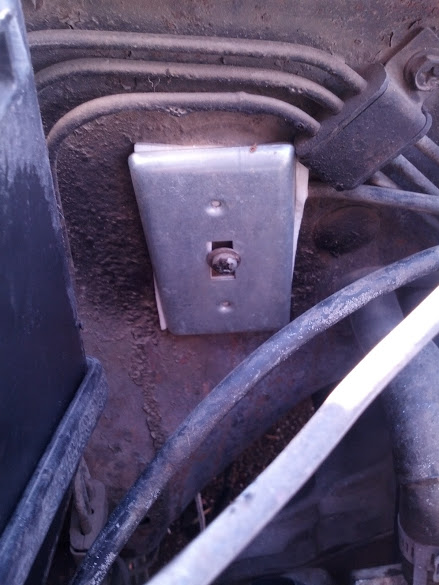

Well, I was wrong. I did find that the heater core stuff is still hooked up. I guess it is the AC stuff that was removed. I also found that somebody hacked up the wires to the heater fan trying to make it work.

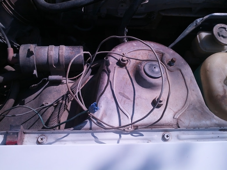

I also found that the fan on the front of the radiator is aftermarket, and not even hooked up. they had a long wire for it just sitting there under the hood.

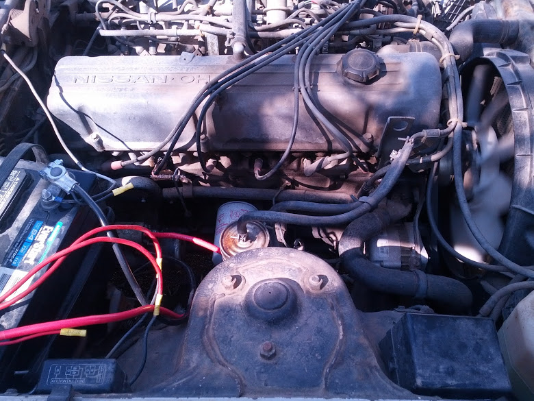

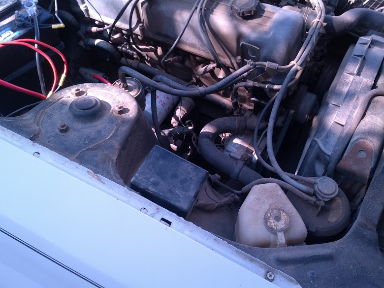

Ok, back to the injector cooling fan. Here are picks of that side of the engine. doesn't look hacked up, but no fan at all and do I really need it?

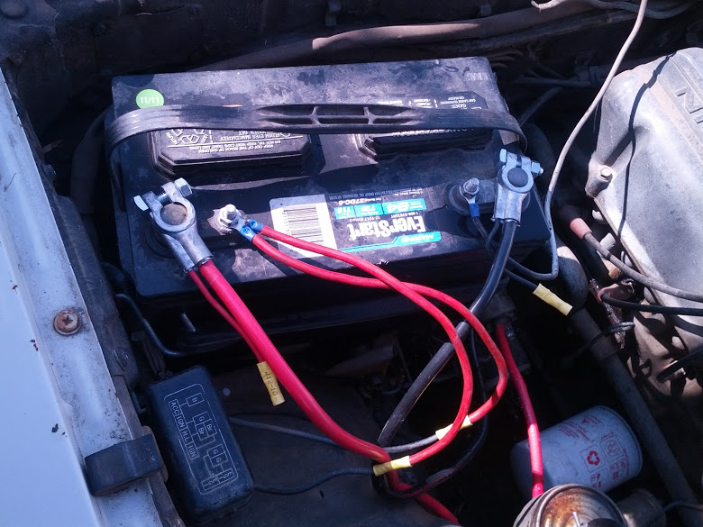

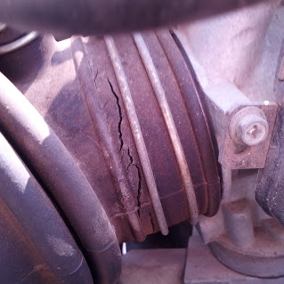

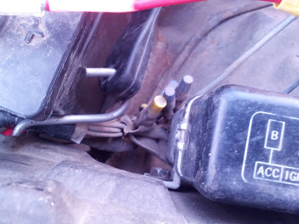

Ok I added some other pics to show you my new battery cables, the fancy work somebody did on the fusible links, and cracks in my rubber tube for my throttle body. I guess I need to find a good repair for them as well.

Old Apr 5, 2014 | 03:06 PM
PredatorZ's Avatar
Joined: Apr 2011
Posts: 1,032
From: A Shady Tree in Boise
AC / heater
It really isnt that hard to take out and put back in, its in 3 big chunks, each is bolted to either a bracket on the trans tunnel or fire wall.
Take a look at my post, should look a lot like what you have.

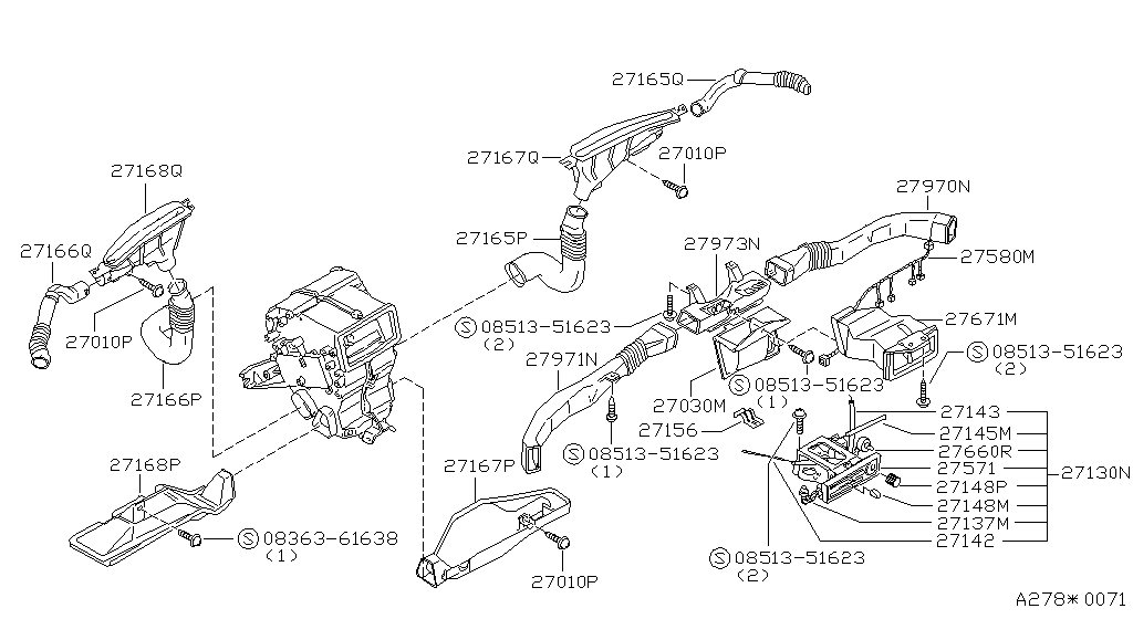

heres a diagram of the duct work
Attached Thumbnails Worked under the hood and found strange things.-ducts.png
