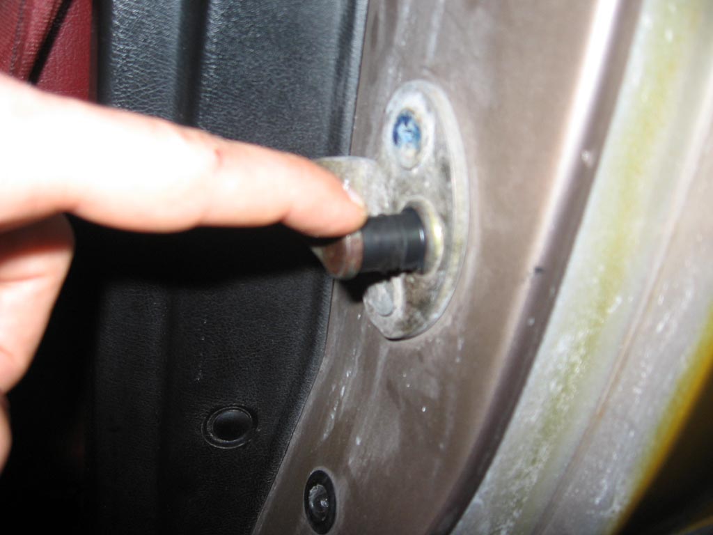

got it installed and everything is alright. the only problem is the random door ajar ringing when im driving and the lady saying the doors are open. and btw does anyone know the size of the speaker in the dash? i need to replace that. =/

I had that problem and it was the door latch. Do you notice if your dome light comes on too when the lady talks? Your door may just be moving slightly and activating the switch in the lower rear area of the door that senses when the door is open. Either put a cap on the rod for the switch to hold it in a little further or adjust your door latch on the frame of the car to keep the door 1/8 inch closer in.

Your door warning thing may be going off if the bushing on the striker is worn or missing, when you open your door, look in the door sill to the right if on the drivers side on the actual body of the car, not the door.
