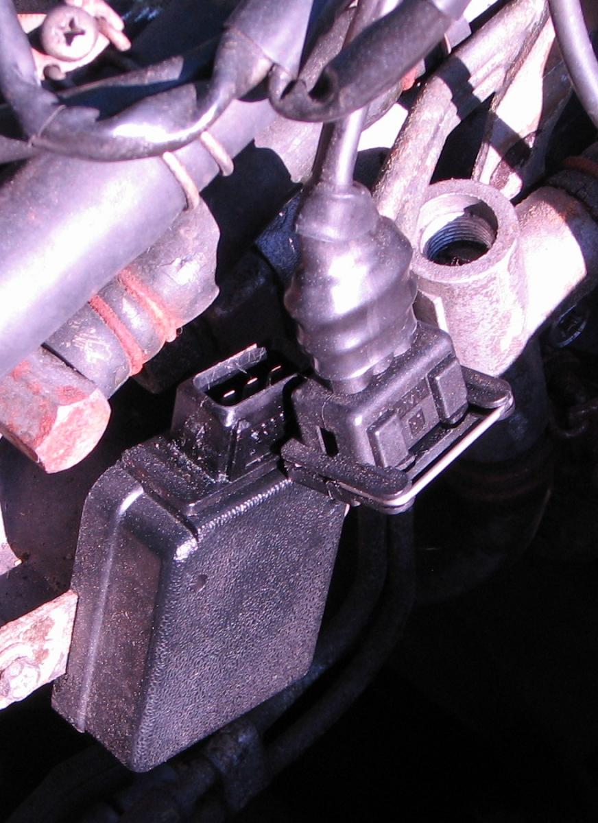

Your TPS (Throttle Position Switch) is full of water, or actually the connector is, the way the TPS sits, it can fill with water and short the works out, also water can get in the distributor, pop the top and dry it out. Happened to me when I power washed my car, would barely drive, or even cross the road to get it off the road.

TPS Pics
Here is what you are looking for
Attached Thumbnails Washed off motor, now it bogs-tps-1981-280zx.jpg   Washed off motor, now it bogs-tps-connector-off.jpg

Thanks PredatorZ. I just got the car and am trying to figure out where the sensors are located. I guess it dried out since the car runs fine now. Is there a picture of the sensor locations like the Buick Grand National has at this link? 86-87 Turbo 3.8 Liter Engine Sensors
