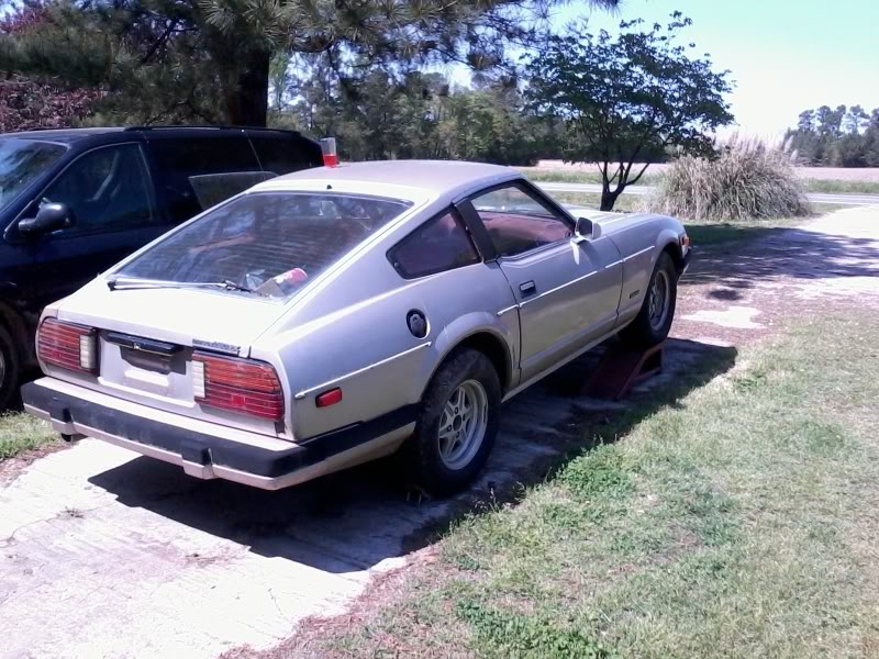

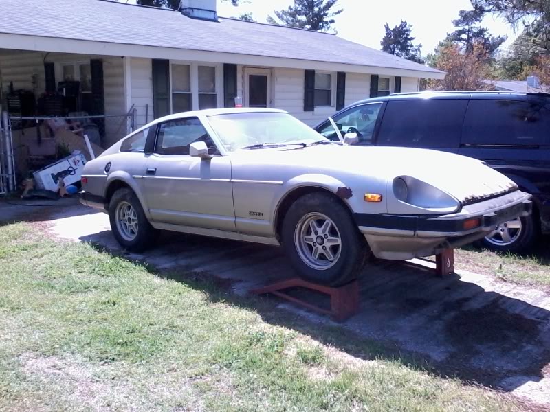

Pics for giggles
Rust is there but not bad and in all the wrong places.. Plans for now are to clean it up more, strip the interior (its mostly shot anyways) strip unnessaries(ac/cruse borked) sort the suspension and get ms1 in there to help with mpgs... may boost, may not...

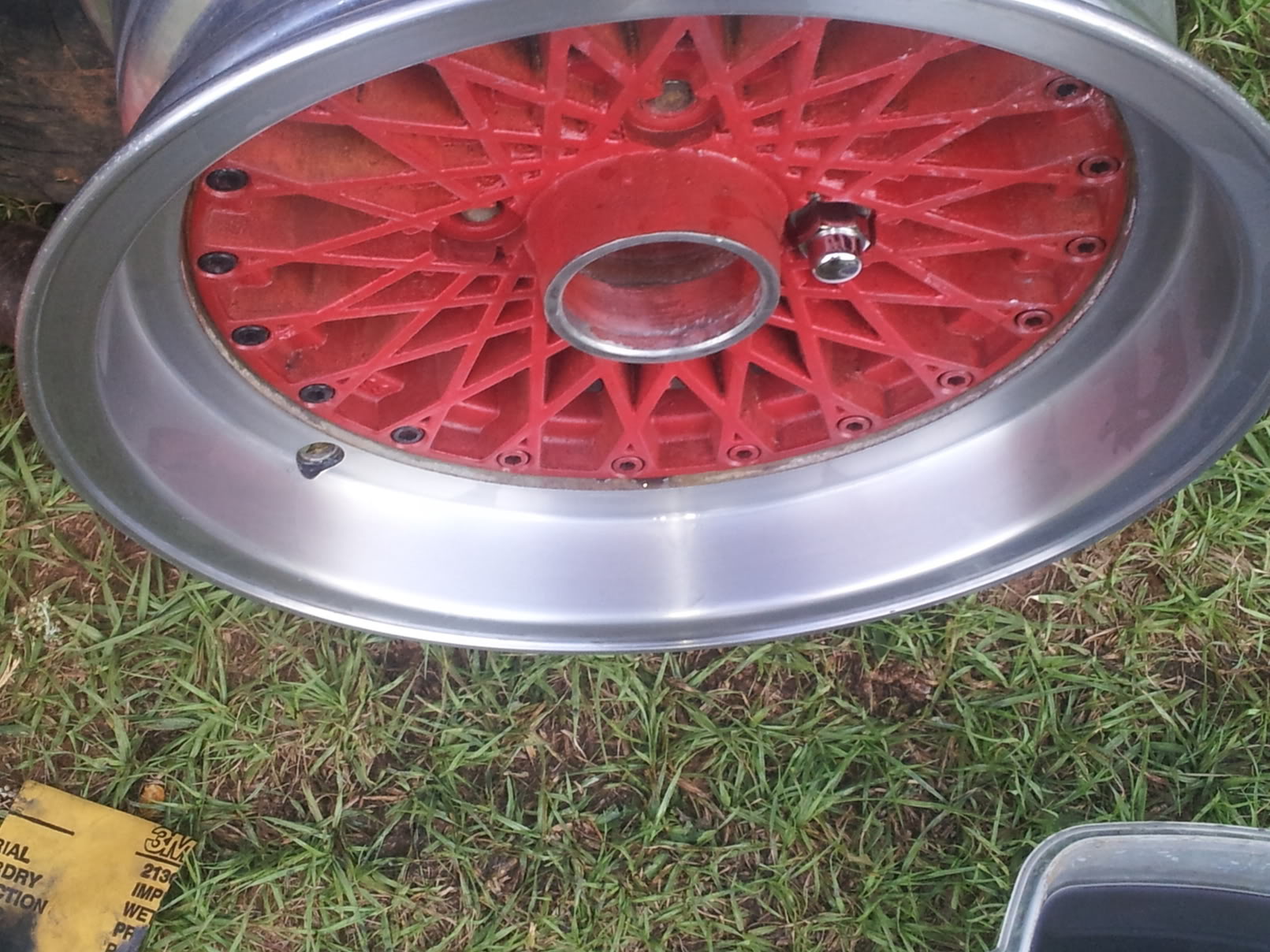

figured its time for an update... Ordered a doctor wheel for edis,, will be mounting that next, but this is a side project that I wanted to share...
still been sanding the machine marks off of the lips, its massively time consuming but i just got this cool new wheel polishing machine to help
just a few min of sanding, no real polishing done yet
220, 400 wet, then 1000 wet, then super fine steel wool wet
gonna finish all the shelby wheels, then get the s12 legal and driving around
