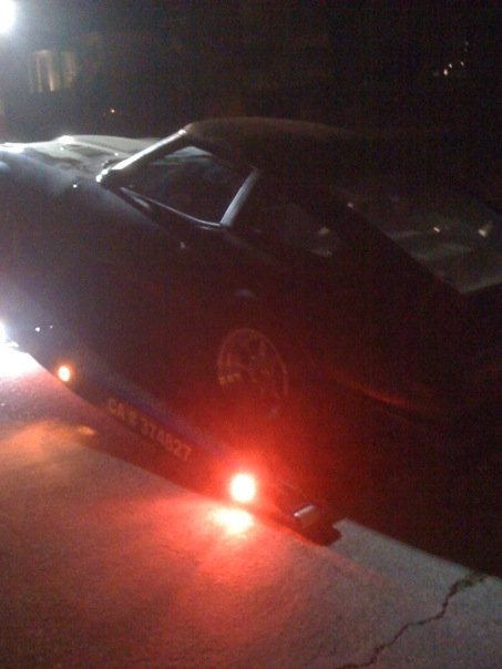

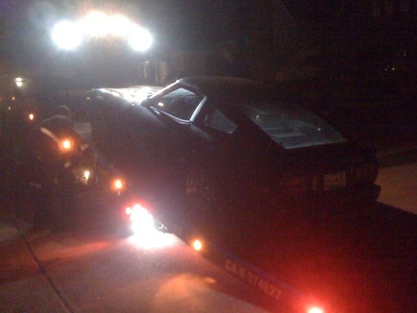

havent drove my car for like 4 months.. then one day i felt like taking it out so i drove it all day and at nite i drove to LA (25 miles away from me).. then one by one my head light went out.. my music went out and then my dash keeps getting dimmer and dimmer.. then my car stop.. hahahah.. im replacing the ALT rite now.. so it should be up in no time.. just checking in since i havent been on in a while to let you know the status and to say hi to everybody... whats everybody been up to?!
