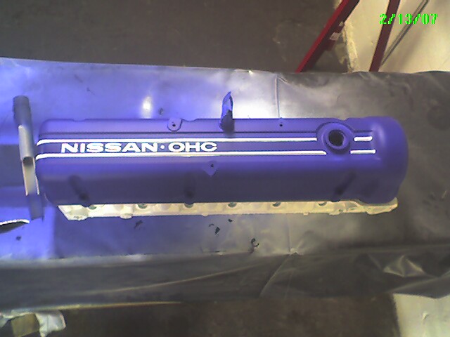

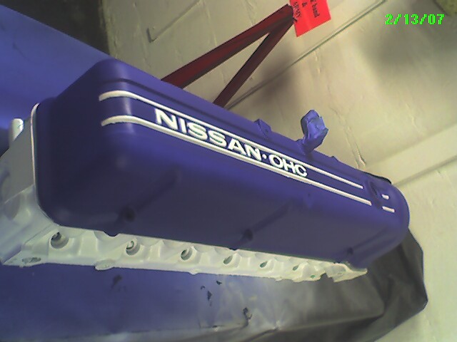

The valve cover is done. Only One thing left to paint. And she will be ready to install.

very nice, what did you use to paint it with? and what did you use to mask off the lettering and stripes?

DupliColor 1200 degree engine paint. is what i used. Both blue and white. And i used Green painters tape. and took my time cutting the letter's out. I could not find the exact blue i wanted. so i painted the cover white first. so it will lightin up the blue a lil. came out great.

dude... did you paint the head to? it looks wierd sorta.. like.. fake haha

yes i did paint head. same white color at the letter's. In fact. same can of paint.

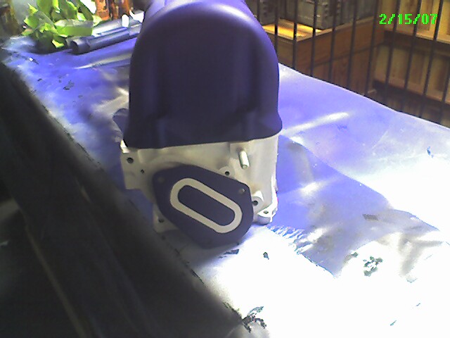

not really much work. just time consuming. you have to wait a full day before you can take the tape off, and re tape it. Here's the front chain peek hole cover i just finished.
