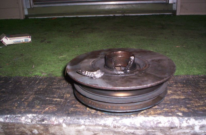

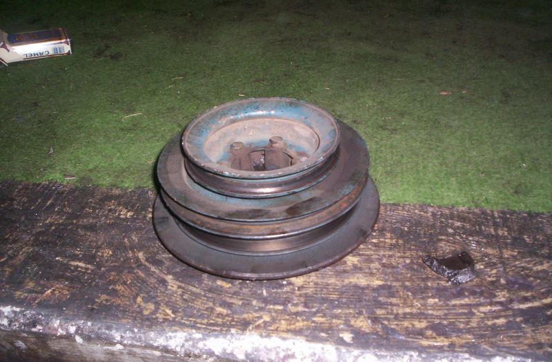

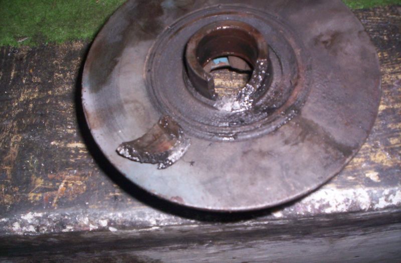

well it started to start i could see the tach moveing and i heard a sound from up front
......it was my HARMONIC BALNACER ...it broke ....i had been hearing a sound coming from up there for a long time ...it was a clicking sound....i thought it was my timeing cain but i was wrong .... happy birthday to me
does any one have one of these laying around that they will give up for cheap
it has to have the three belt system ........
Attached Thumbnails Sensors #2 :(-dent-001.jpg   Sensors #2 :(-dent-003.jpg   Sensors #2 :(-dent-005.jpg
Old Sep 29, 2005 | 03:09 PM
  #48
wtf? how would that just break, unless it was loose!?
Old Sep 29, 2005 | 03:43 PM
  #49
81 Black L28E's Avatar
Posts: 1,046
From: squwamton
mabe it came lose over time i have had it off three times sence i got the car .....
mabe last time i didnt get it tight ....i put the bolt back in to see if it messed the threds up..... it didn't but there is a lot of play ,like it could have just wiggle free
i will also need the crank tooth it sits in the end of the crank and keeps the HARMONIC BALNACER in place ...........mine is gone ...its is no where to be found what if it flew into the oil pan i dought it but what if ......
