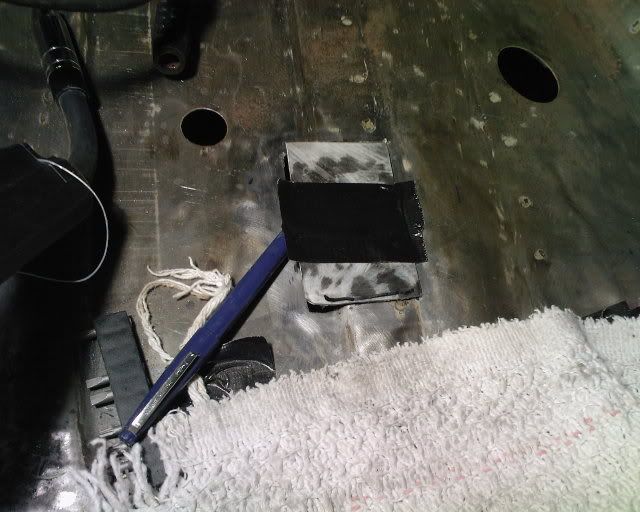

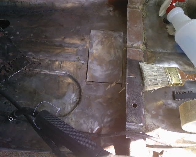

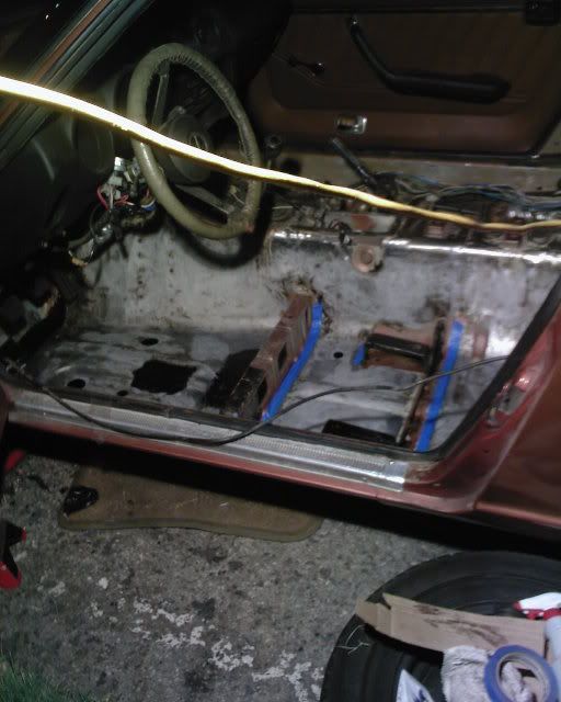

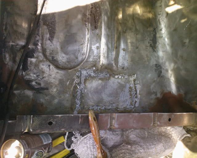

alright negroids i got some shazzalazz crackin and it was really intense. I had por fumes, weld fumes and chew buzzin in my head and i thought i was going to die. but I got this far. wow the old metal burns holes after like 3 or 4 welds, I learned that lesson the hard way. Tell me what you think, it looks ugly in the pictures but I ground it smooth as a baby's butt and it's all por'd now. It does look like some have holes but I haven't taken pictures of the final product.
Head Muckraker
What kind of welder do you have and what size wire are you using?
Smaller wire = less heat needed = less chance of burning holes in 25 year old sheet metal.
A good MIG with good voltage control is also very usefull.
w0rld's l0ngest m0t0rswap
the only welder I have has the worst possible wire for this metal: .03" and its flux core so not only does it make holes but it spatters the )$@(# out of everything. But it's doing the job...
