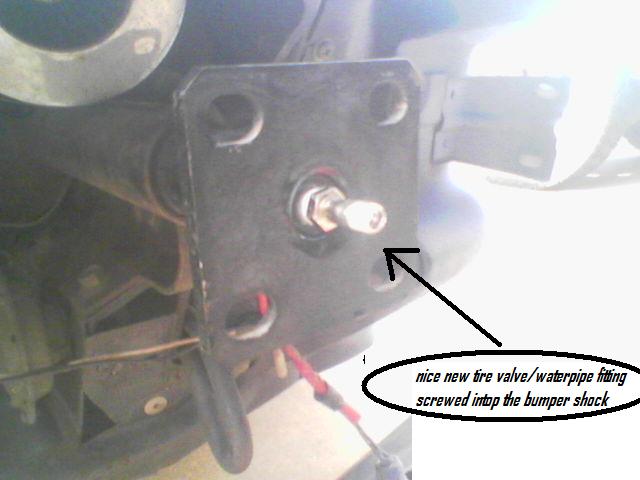

so first things first, u need two pressure valve stems from diaphramed water tanks(got these at lowes)/ 1/8'' pipe tap/ type R drill (or an 11/32 will do) and a wrench or two
take the bumper off and drill your hole out with type R drill in the front of the bumper shock (dont go to deep not sure if there is a hydrolic bladder)
tap out your hole(with the 1/8 pipe tap u should make sure u dont go to deep the threads are tapered and it will self seat/seal itself)
insert air fitting and ur done/ not really

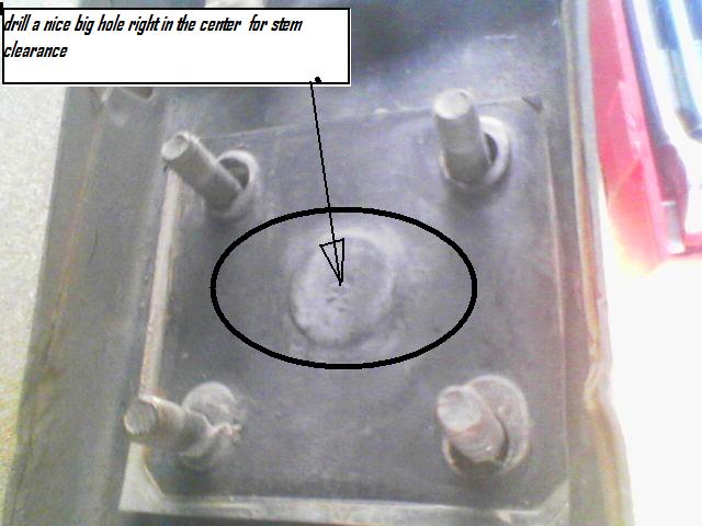

now on the bumper(pic two) drill out the center with a really big drill so the fitting will clear into the bumper
