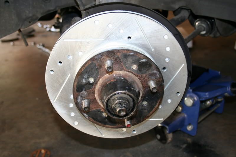

Old Dec 1, 2006 | 07:12 PM
Lookin good homie! Bling Bling!
Old Dec 1, 2006 | 09:30 PM
...there's no caliper in that picture! what have you been turning in? hehe
That's the front! I took them before I put it all back on!
