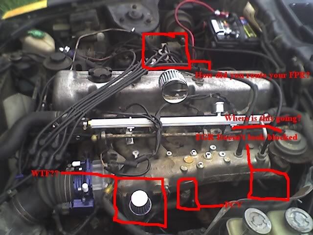

Actually kids... the PCV (Positive CRANKCASE ventilation) is on the underside of the manifold.... connects to a hose on the crankcase. The rocker cover does have a vent, but it doesn't have a PCV valve. Either way... that's not causing the car to run so poorly.

ok, i got a breather filter on that(ThXone's pic) and there's plenty of oil on the car. and the hose is hooked up on the under side if the intake. and the plugs are filling with gas. there flooded. The below pic is the engine that' haveing the problem.

A few questions...
What is the secondary filter by the throttle body? The PCV is marked, your EGR doesn't look blocked although I can't tell where your vacuum line for it is going and how did you setup your FPR on the passengers side?
Also, if you pull your oil cap while the engine is running it should die or damn near die unless you have a serious vacuum leak.
