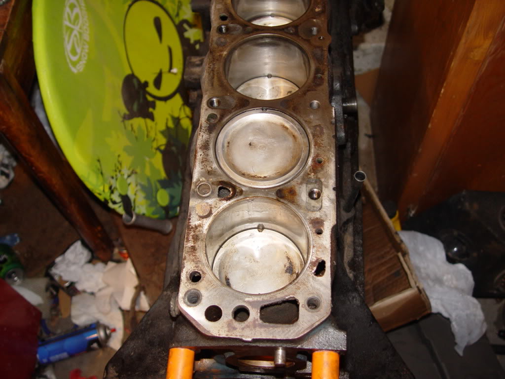

Back half

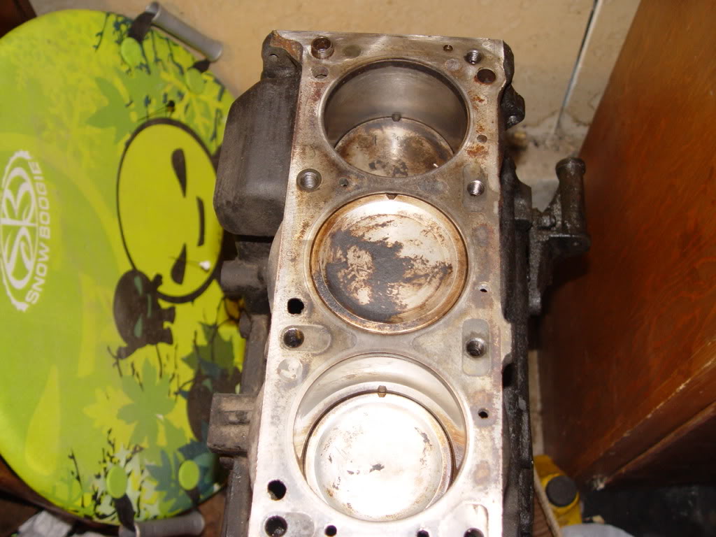

Front Half

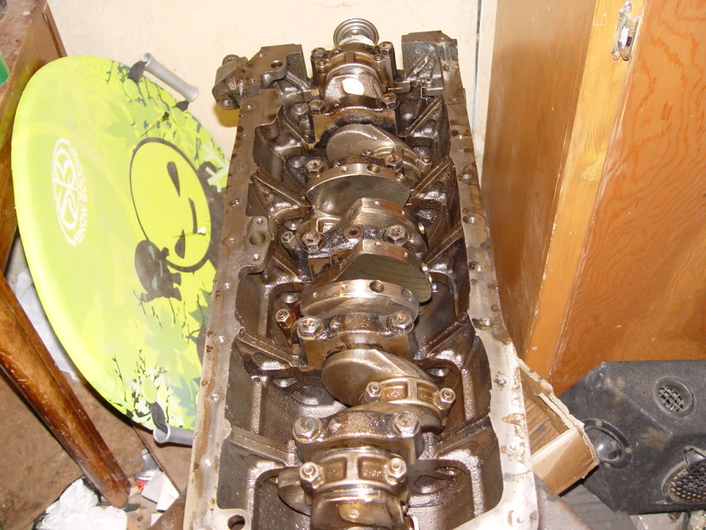

Crank

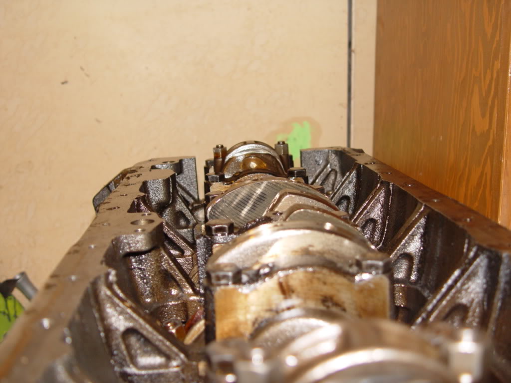

Close up

id run that. diff. pistons only matters if your building turbo, or high comp engines. for a daily, who cares. id make sure the t-chain is not stretched and put it back together. those are factory machining marks. thats as stock crank from what i see.
