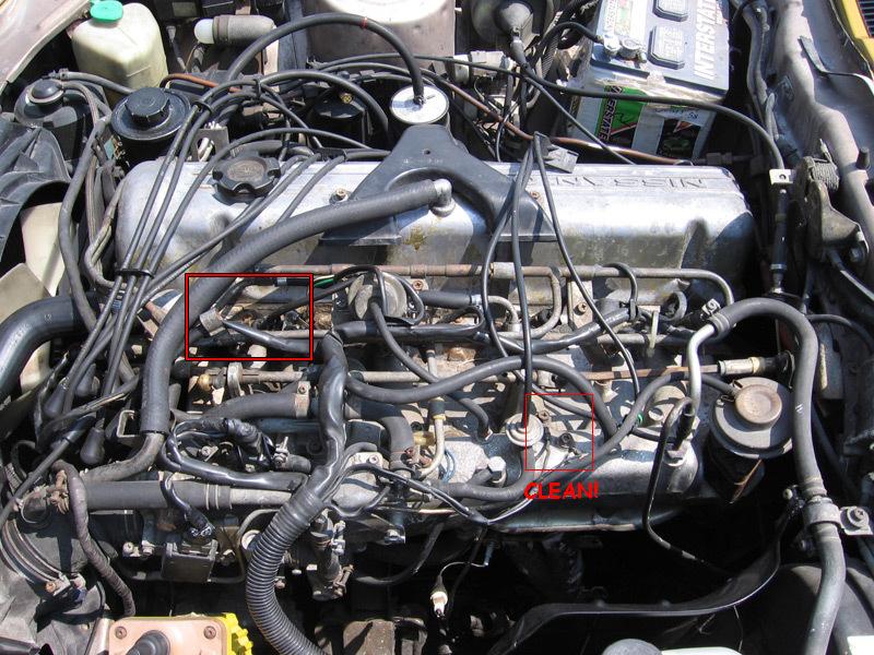

Clean at least the two grounds I've boxed for ya!!

I will look tomorrow at them, that pic is actually my '82, I don't have a pic of my '79 yet.
