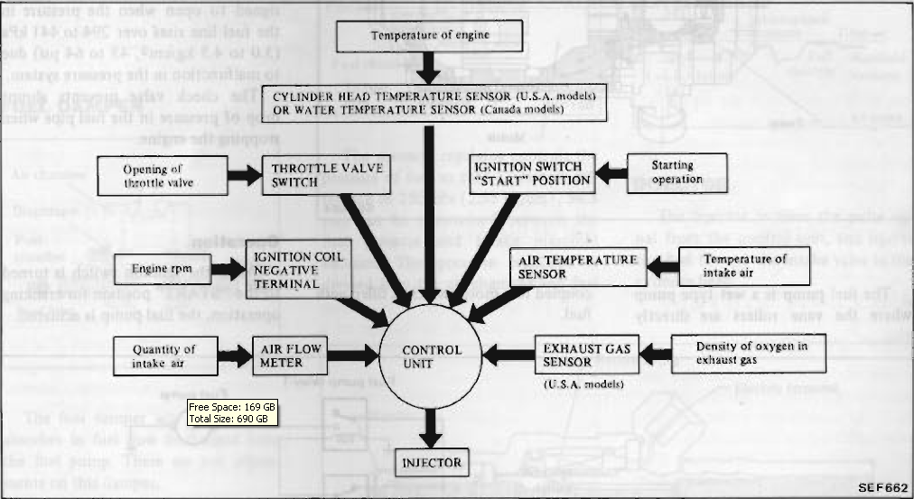

My question is now in plain English (lol)
WHAT DOES THE COMPUTER (ECM) LOOK AT TO TELL THE INJECTORS TO OPEN AND THE PLUGS TO FIRE?
HOW DOES THE SIGNAL GET FROM THE DISTRIBUTOR TO THE COMPUTER AND BACK? ALL SHE DOES IS TURN OVER, and over.. and over..

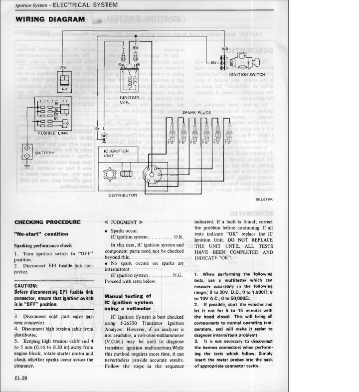

I have bought all brand new BATTERY, ICM, IGN.COIL, ROTOR, CAP, PLUGS, WIRES, MAG. PICK UP COIL (in distributor), IGN. RELAY (pass side dash), CHTS, fuel pressure regulator and fuel filter too...and now have a common ground going to everything. Also power to and from fusable links under hood.for sure...
but NO FIRE. NO START.
thats where im at. AND IF SOMEONE CAN ANSWER THAT I WILL KNOW WHERE I SCREWED UP I THINK

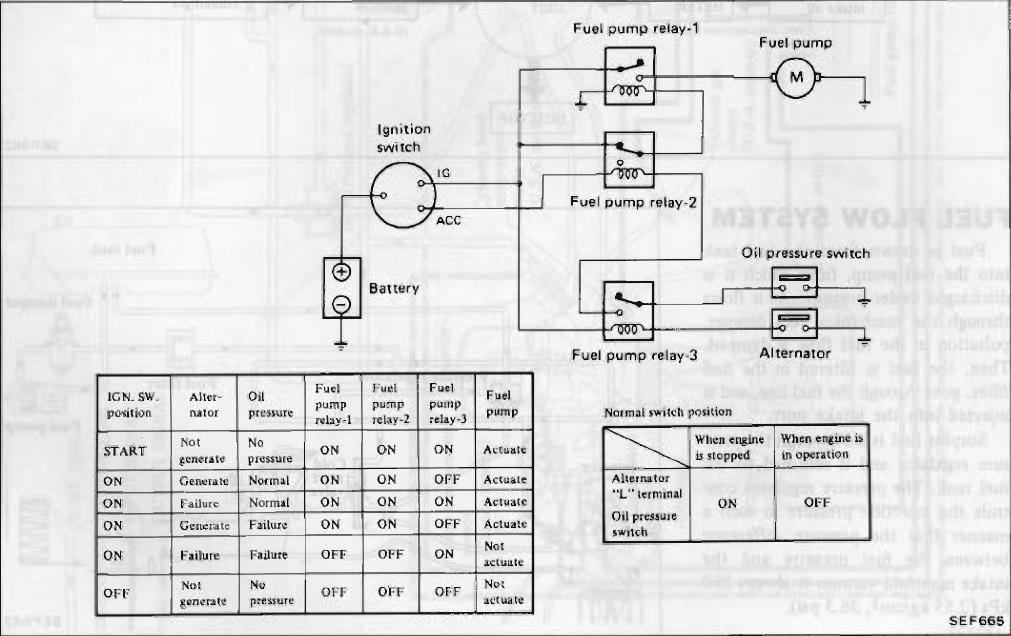

So after putting a second pick up coil in yhe dizzy... I had spark again... YEAH. Still no stari. I did all of the volt/ohm meter tests at the 32 pin connector as such from the EFI bible, and all pin tests check out fine MUCH TO MY SURPRISE. and I have gone thru that fsm a hundred times. I fall asleep every night studying hundreds of informative posts in this wonderful forum you zdriver admins provide but cant figure out where I went wrong. Could it be possible that the fuel pressure has just dropped some with all I have had apart? CAUSE FUEL IS MOVING... but maybe not enough cause it almost started after spraying starting fluid somewhere under the hood.

Well if there is spot on igniting, knowing all spark plugs sparking. Well then fuel is your real final option. I should also recommend purchasing a brand spanking new whole distributor itself off ebay or amazon by Cardone if you were replacing internals. The fuel pressure regulator can be a cause if its full on stuck open, causing very little pressure build up, having the injectors just drip fuel in rather than shooting from pressure release. To check for FPR conditions, usually checking the spark plugs for no fuel or more than normal fuel smell, or even completely covered and wet with fuel spark plug tips. But dont just jump to there just yet, i recommend checking the injectors seeing if there not clogged from the top where fuel goes in. Maybe your injectors do work and are opening, but the flow for fuel isnt going in right. If that was the cause, i recommend checking your whole fuel delivery system. Lines, tank, pump, or even fuel filter (you'll be surprised). I do know the IC module and the coil pack play a big role on the engine starting process. My 280zx had a same issue when no matter how many times i cranked, no fuel or spark was happening. After long tense of research on the FSM, it was the IC module failing, but you said you replace that so that might not be it then. Just trying to compare your situation with mine just so you know your problem isnt the first. I hoped i helped a bit.
