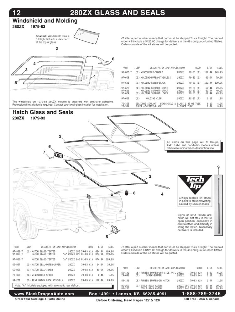

I called a shop and they would come to me and install the window for $175. But they show no clip strips that hold the trim in, do you guys have a place to get these fast and cheap
I can not seem to find them at the Z-store or BlackDragon. It looks to me that the strips need to go in before the window does.

Turns out they are called Molding Supports -Upper and lower. At $50 each they are pretty proud of them. I would have guessed them to be $5 parts...D@%&. I guess I will have to check ebay and some more window shops.
Well Nissan has them for $37.20-Upper (p#-72825P7900) and $39.73 - Lower (P# - 72826p7100) so that should help out a little on the pocket book.
They also list 7 Molding spacers for $4.80 (P# - 72727W1000). I do not see these spacers in the BlackDragon parts break down, does any one know what they are?

just use 3-m two sided tape, roll it up to make it fatter it will fill in any voids
use lots of it..........I used it on my upper & lower trim pcs...on the windshield.. it also holds my side molding on as well......
