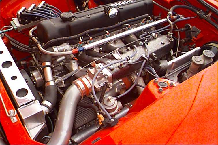

See that right there shows again that I could buy the intake here that has everything welded up and shaved off. He has none of the stuff I have on my car.

See another setup with all the BS gone. How are these guys doing it and they run fine but I cant?
Attached Thumbnails New and saying hi from texas-dunn2.jpg   New and saying hi from texas-dunn3.jpg
