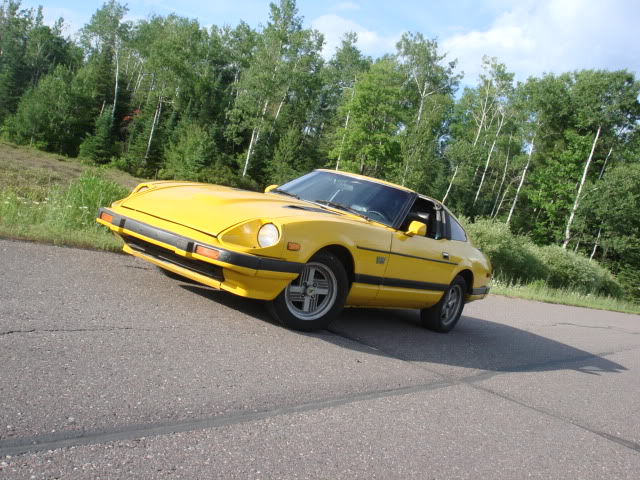

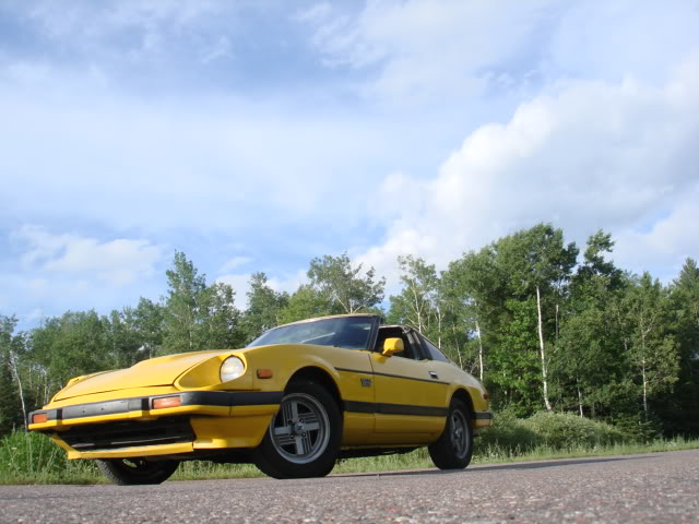

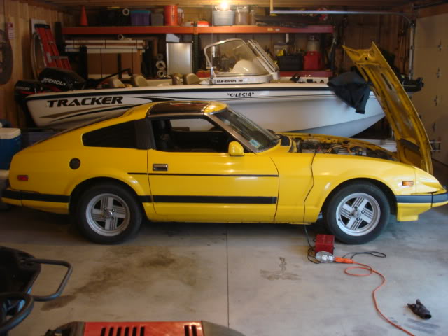

alright here are some pics of the car.
these were from my first drive in the car:

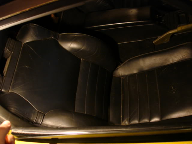

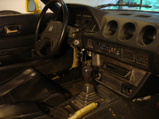

here's the interior:
interior needs a cleaning from sitting years. leather needs to be conditioned because its bone dry.. carpets are brand new (i have a receipt for a carpet kit from some place in chicago)..

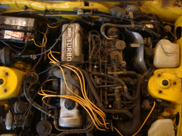

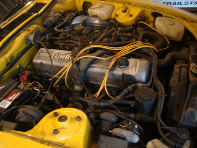

here's the engine:

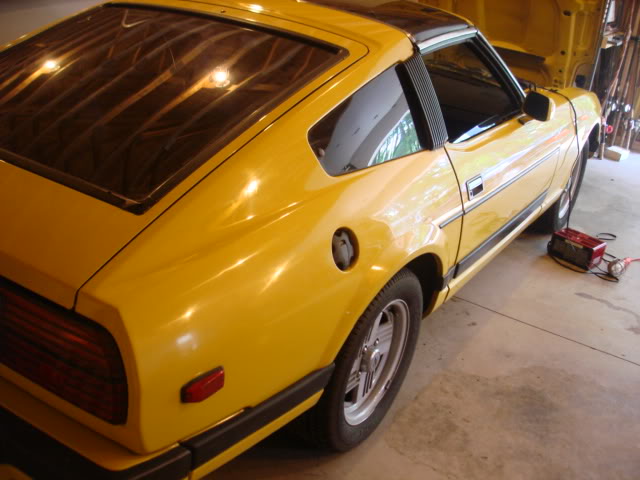

and just miscellaneous shots:
it's got some weird baby blue springs on it right now. dont know what those are about and don't really care to know..

--started the engine up a few times to locate what seems to be an exhaust leak after the turbo where the downpipe meets up with the rest of the exhaust.. dad said needs exhaust donut - anybody have dimensions or a link as to where i can get one of 'em?
--i want to get rid of everything unnecessary for this engine to run. i want to clean up this engine bay because there's a lot of crap here for emissions and i dont want it and don't need it.. where do i start?
-- power... cheap and easy.. where am i getting it from?
-- do these engines need valve adjustments or anything? i was looking through an old haynes manual i found and it mentioned little about turbo engines.

Toss the stock downpipe & either fab a 2.5" mandrel, or you can buy one from MSA.
The only big emissions parts is the EGR and cat.
Valve adjustment is the same for all L-Series heads except the P90A hydraulic head from 83 ZXT's.

As for your blue springs, I would bet they are Tokico performance springs. Are your struts, and shocks, the same color blue as well? If so, they are Tokicos also.
As for the Haynes not being descriptive about turbos and such. You need a manual that caters more to it. I got a Clymer manual, on Ebay a few years ago. That manual is quite detailed, with lots of useful information about Turbo Z's. Hope that helps, and good luck with your new project. Keep us posted. And enjoy perusing, and learning from this great site.
Correction: My mistake, on the springs. If they are blue, I am not sure on the brand of springs. The Tokicos are red. And the struts, and shocks are blue. I searched on the web. And noticed what color they were. So sorry for the wrong information. So maybe somebody painted the springs that color? Possibly the case. Also, if I am not mistaken. the Eibach springs came in black or red also. Of course, your springs are blue. Which that wouldn't help you much. lol All aside, hope you figure out what they are. I am kind of curious myself.

That Z is in nice shape. And I am so jealous of the leather seats. Very nice man. To be honest, I don't even care for yellow too much. But seeing it is the first 280zx, I have seen in that color. It doesn't look half bad. Anyway, looks like you are on your way, to a more than daily driver looking Z.
