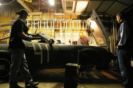

Hi folks. This is my first time posting here. In all honesty I've been more of a BMW guy, primarily with the old '73 BMW 2002 that I've been restoring for the last six years or so. Anyway, some friends and I finally got off our you-know-whats and decided to do a 24 Hours of Lemons race. Our trusty steed of choice was an '81 280ZX that was actually run at one Lemons race already by another friend of ours. Previously it had been stripped, had a rollcage put in, and that was pretty much it. As such, we are now trying to "take it to the next level" prior to racing at Buttonwillow in early December.
As many of you likely know, the key restrictor for Lemons is the $500 budget so we need to find performance and reliability improvements that can be done free (just elbow grease) or very cheaply. Things we are leaning towards are yanking the AC system as well as the majority of the smog system. Would love to hear any suspension advice you might have (currently stock I think and understeers quite a bit) as well as brakes, engine tweaks, weight balance, etc... Thanks so much, in advance. Should be fun!!
The Lemons Ride: Name:  TartanRacer1.jpg

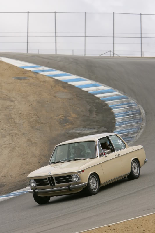

My "other" baby: Name:  JR1N1862.jpg

Looks fun! And I dig your 2002!

Nice Datsun 510 ....

P.S. LOVE the 2002 and that's a great pic of you coming down the Cork Screw.
