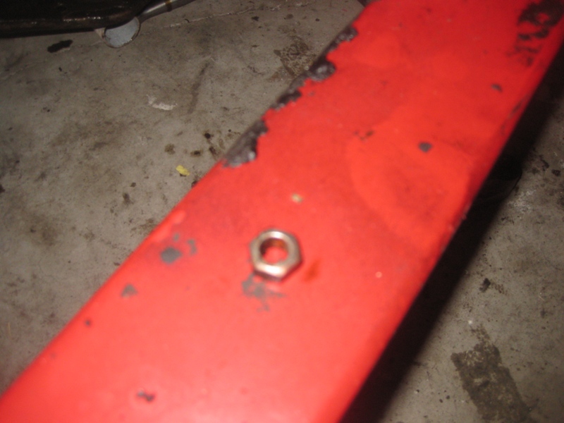

On a side note, I found this in the oil pan of the ZX engine, any ideas on where to look for the bolt or stud it belongs on?

As for that nut... what size is it? Did you clean it? Because if it came from the oil pan, and has been there a while, it would have the oil film on it. Could be a connecting rod nut, or maybe someone accidentally dropped it down the timing cover.
