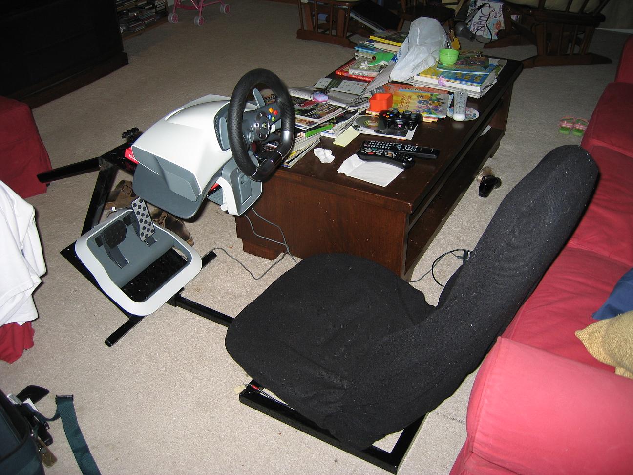

So, after killing my back and neck for 3 days trying to play Forza Motorsports 2 with the wheel attached to the coffee table and the pedals right under me, I went online and looked for a "Racing Seat" setup. After looking at these things and seeing the price, I about keeled over! At my advanced age, that's a legitimate risk! Some of these were nearly $1500!
I looked at it and said, damn, I can build that for less than $100...
So I did! This weekend, I built a platform for my new XBox360 with wireless steering wheel and pedals...
I built this to mount the steering wheel, pedals and a spare racing seat so I can REALLY play the driving games!
The length of reach for the legs and arms is independently adjustable for about 4 feet on the legs and 3.5 feet for the arms. I used diamond plate for the pedal and wheel platforms, 1 1/4" square tubing for the main frame and 1" square for the adjustable sections (I wanted 1 1/8" but they didn't have any in stock and I was impatient). I thought about making the wheel height adjustable too, but I was afraid it would make the frame too flimsy or wobbly.
Finished the seat mock-up using one of my old Z car high back buckets and found a problem... While fixing it, I created a new one...
The angle on the steering wheel plate was too steep. I was looking down at the top of the steering wheel when it was mounted. I fixed it by cutting off the horizontal steering wheel bar and re-welding it to the upright at a steeper angle.
Unfortunately, this made the steering wheel too high for a seat flush mounted to the base. I feel like an old granny looking through the steering wheel while I'm out on my Sunday afternoon drive, but at least I fixed the wheel height adjustability problem!
Now I'll have to build a stand to raise the seat height about 6 or 8 inches...
Not bad for a half days work, $50 in steel, $2 in welding wire, $5 in C25 gas, $4 for the faucet ***** and $4 for a can of gloss black Rust-o-leum!
Ultimately, it's gonna get a full on Corbeau racing seat, but here's a pic of the final mock-up:

Dude, I eyeballed that whole setup! I barely even used a tape measure! It took me a grand total of about 6 hours on Saturday afternoon to knock it out and I would have finished about an hour earlier if I didn't have to redo a couple pieces that didn't work right the first time.
