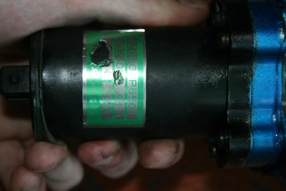

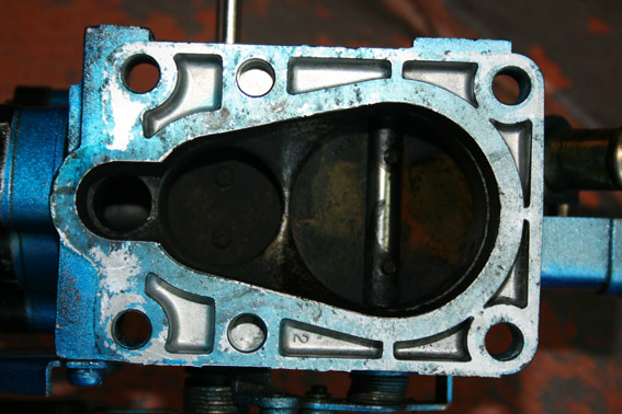

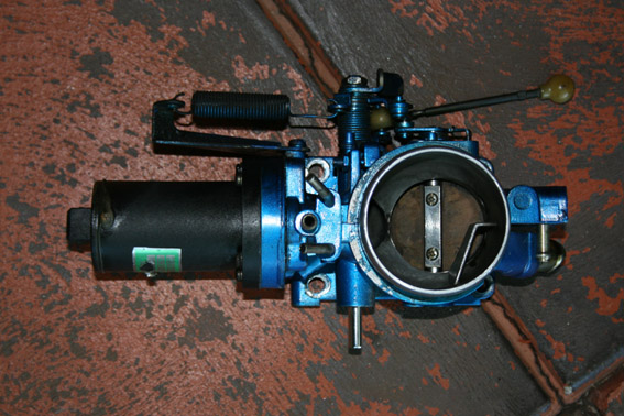

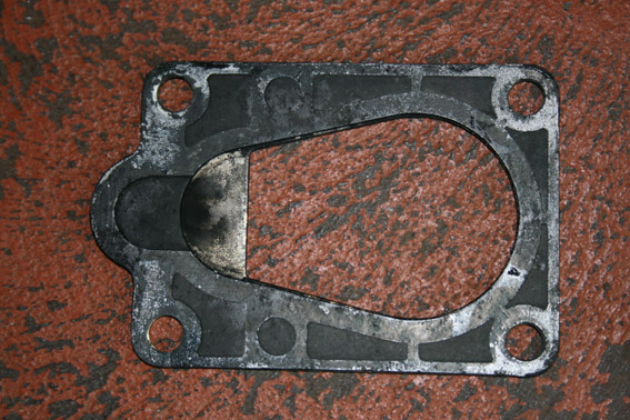

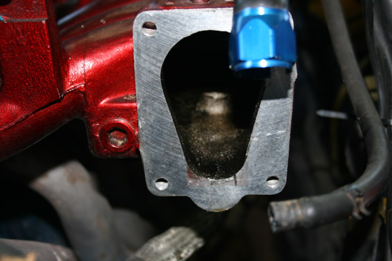

ok well i got my ka24 60mm tb and went to dummy fit it to see if it would be an easy or hard job. Turns out its a non existent job due to the fact they dont even bolt up. my manifold is a p75 and the bolt holes from centre to centre would be 60mm horizontally and 87mm vertically. I took plenty of photos as maybe somebody might know if nissan or anybody make a throttle body with these measurements or is this the measurment that is for the adaptor plate that is made for the 60mm? Note the spacer plate that was between 2 gaskets that was restricting the primary throttle body

Ouch! The only way I could see it working is to get a custom adapter made that would be a rectangular block and studs in the middle for the lower part of the tb to be secured. Are all the L28 intakes that way in Australia?

nope this is only because mine is a japanese import and has a different manifold/tb.
note the sticker on the bottom right also says l20 so i wonder if thats what they did over there was put an l20 manifold setup on the l28
