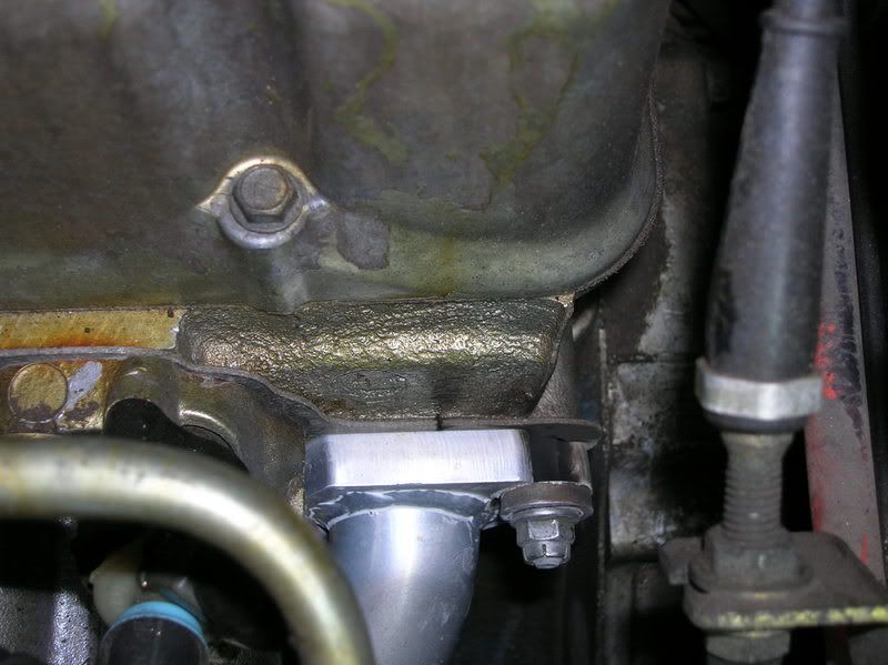

Old Sep 10, 2007 | 07:44 AM
Matt K's Avatar
Joined: Oct 2005
Posts: 124
Damn...worthless POS MSA exhaust gasket blew out after 2 months! I hate swapping these!
Old Sep 10, 2007 | 09:00 PM
Did you torque and re-torque them to spec??? They shouldn't fail if installed correctly.
Old Sep 11, 2007 | 04:58 PM
lww's Avatar
lww
Head Muckraker
Posts: 9,221
From: Bay Area
You want to re-torque them after about a week as well. Most people don't realize, the majority of the torque used is absorbed by the bolt/nut/stud overcoming the friction in the threads.
The best way to torque these down is to use 50% of the torque recommended to snug the nut up and then increase the torque to 75%, then 100%. Do this to each nut in sequence at each torque setting.
Then come back a week later and torque it again once the gasket material has had a chance to "settle".
Old Sep 11, 2007 | 09:53 PM
i use a stock fel-pro gasket on my msa header and never have had a problem, i have had a problem with msa's header gaskets.
Old Sep 11, 2007 | 10:55 PM
i use felpro to... didnt retorque but im chaning it out again soon any ways so i dont give 2 *****
Old Sep 12, 2007 | 05:56 PM
Matt K's Avatar
Joined: Oct 2005
Posts: 124
Yes, 1 day after driving with it & a week later. The gasket is a POS, no metal core...I KNEW I should have bought a new OEM one...now I have the pleasure of taking everything apart again & re-doing it...
Old Sep 12, 2007 | 05:57 PM
Call MSA and give them hell....
Old Sep 12, 2007 | 07:15 PM
Matt K's Avatar
Joined: Oct 2005
Posts: 124
You can see clearly where it's leaking from. I really don't like pulling all that crap off, just to change a gasket!
