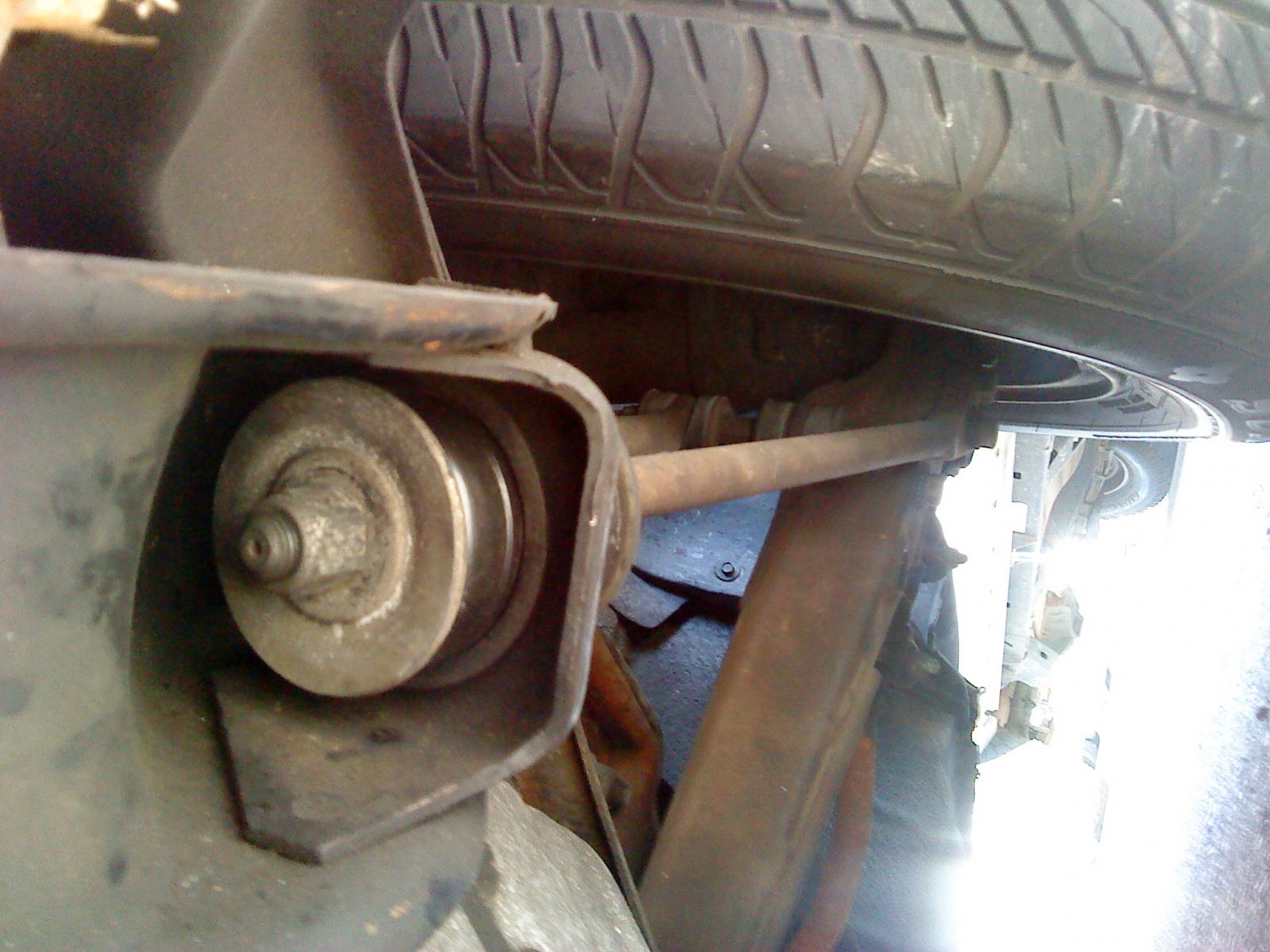

hey guys! So ive been driving around for a few days and when i would turn hard right i would hear this click thunk sound. So naturally i knew there was something off. Specially after redoing the lower front suspension not to long ago with some buddies of mine. So i was a bit worried still,and decided to creep under my car today and well this is what i saw!
Damn Tension rod Bushing screw popped off/broke off

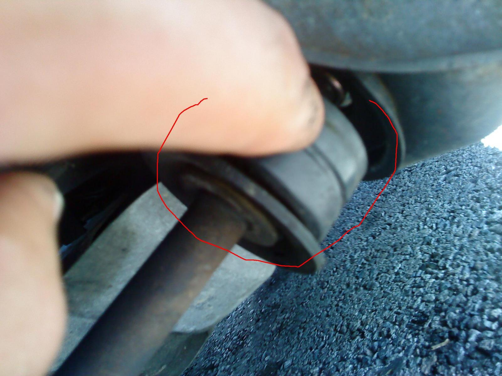

My passenger right side bushing part is loose and i can move it around, so im assuming that has been the click thunk ive heard when turning the wheel and hitting bumps. Lesson Learned here is- Dont Put urethane Bushings on A TENSION ROD!
Now my question is what now! what exactly do i need to replace, or do... any insight would be great thanks guys in advance
the first pic Right front passenger side
second pic: right hand passenger side loose bushing

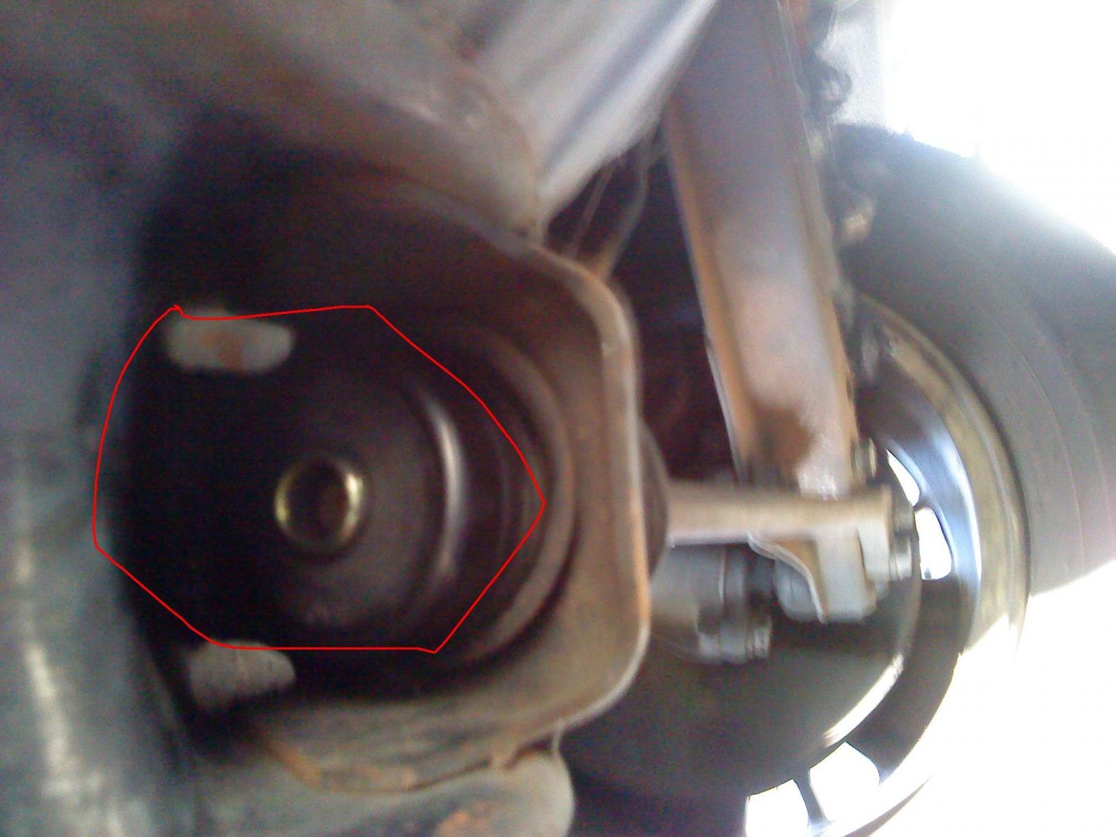

third pic: left hand driver side bushing how it should be.. maybe minus the urethane bushing now after this..

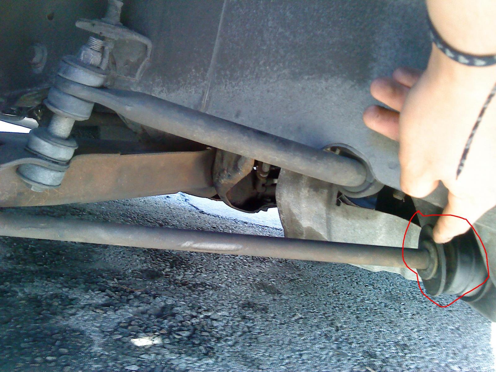

fourth Pic- Right hand passenger side problem area
Yup...
https://www.zdriver.com/forums/280zx-s130-forums-77/total-front-end-rebuild-long-34737/
Originally Posted by FricFrac
Better take those urethane bushing out of your TC rods before they break on you.
^^^ Might as well go T3 tension rods at this point.
Or back to stock rubber bushings

hahaha @WanganDevilZ where can i get the nut to hold the bushings in place though. thing fell off while driving dont feel like going and looking for it somewhere on the 710 freeway

i would if i was not a college student that cant afford such an upgrade, and im still not sure where to pick up the washer/nut that holds the bushings and tension rod together? Would i just have to buy a tension rod separately in order to get the part that my passenger side is missing?

Well if you only need the nut and the threads on the rod aren't damaged then maybe you could ask one of the people in the for-sale section that are parting out their cars? Or you could take the other tension rods nut off and go hunting for a grade 8 (I'd imagine its grade 8 anyway) replacement at NAPA, hardware store, or Nissan dealership? Good luck.
