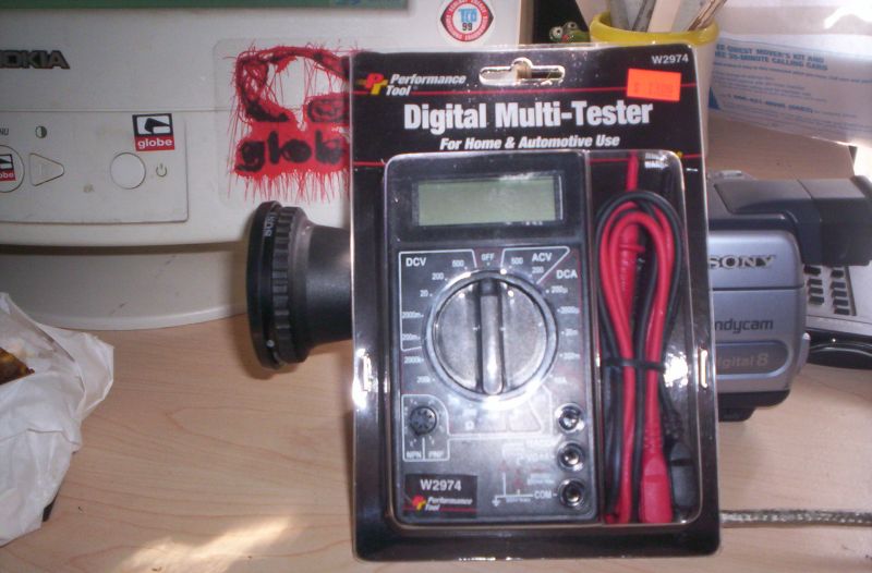

someone had said this to me befor ....i didnt listen mabe i should now ....ok ok
befor go buying a bunch of **** iam going down to the auto parts store and see if
i can get a volt thingy ....i will be back in a few

will this do the job ok how do i do this ....tell me the frist five steps and when it shuts off again i will go though the steps
Old Sep 24, 2005 | 06:05 PM
  #37
jfairladyz's Avatar
Posts: 5,485
From: Temecula, CA
That'll work perfect. I'll PM you. Oh and I'll let you know about the stator and rotor swap too.
