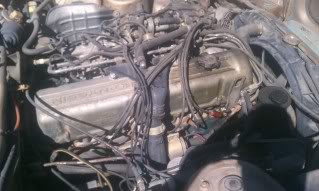

alright alright... nvm the vg... this is what im dealing with.

playing shy girl by the SER.

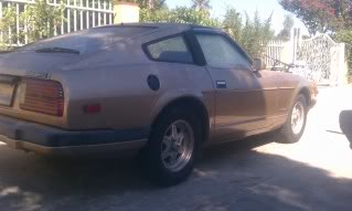

minor rust on the hood
Just hit that with some Conquest or other rust converter then seal it up with a splash of paint to seal it until you can take care of it at a later date. That will stop it from rusting further. Rust Check makes some good primers as well.....
