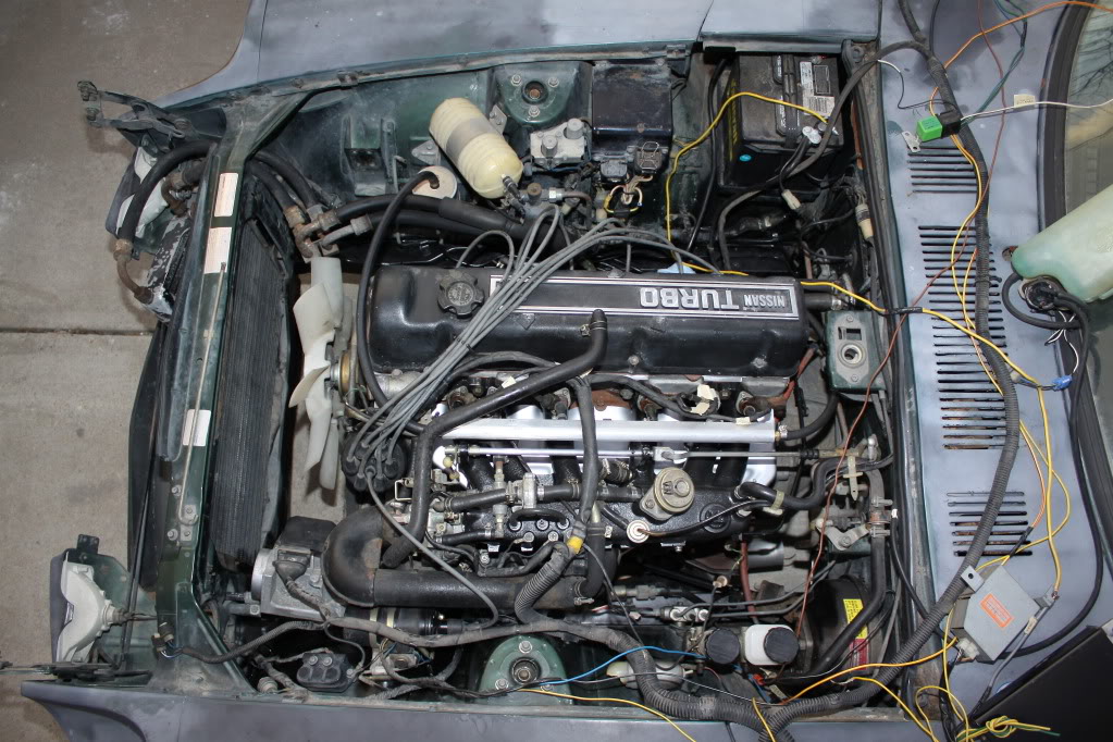

There's not much to clean up on the L28ET manifold. If you remove the AAC / EGR and air regulator, you'll just have a bare intake mani with ugly webbed runners. That's why many people convert to the N42 intake.
On my 280zt I cut the webbing between the runners out, cut off the EGR, and plugged the POV:
