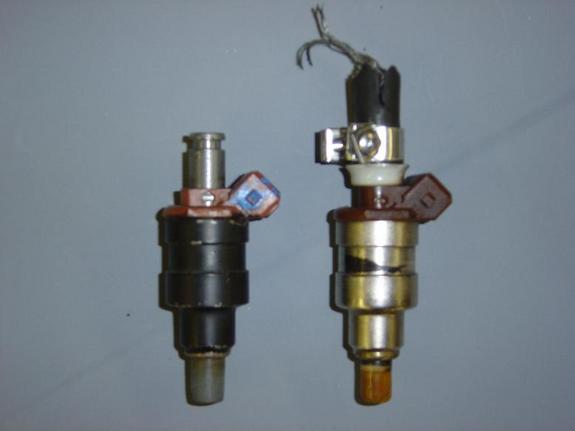

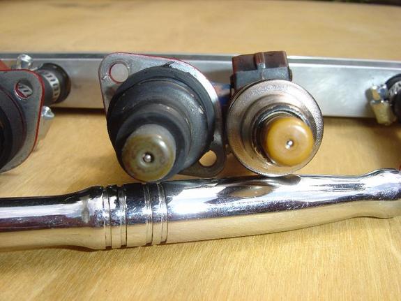

I have built a fuel rail using RX7 450cc injectors. I haven't used them yet, as I am still deciding which fuel management system to use. Cost: $70 for fuel rail & $250 for 6 injectors.
BTW... Each motor came w/ 4.
