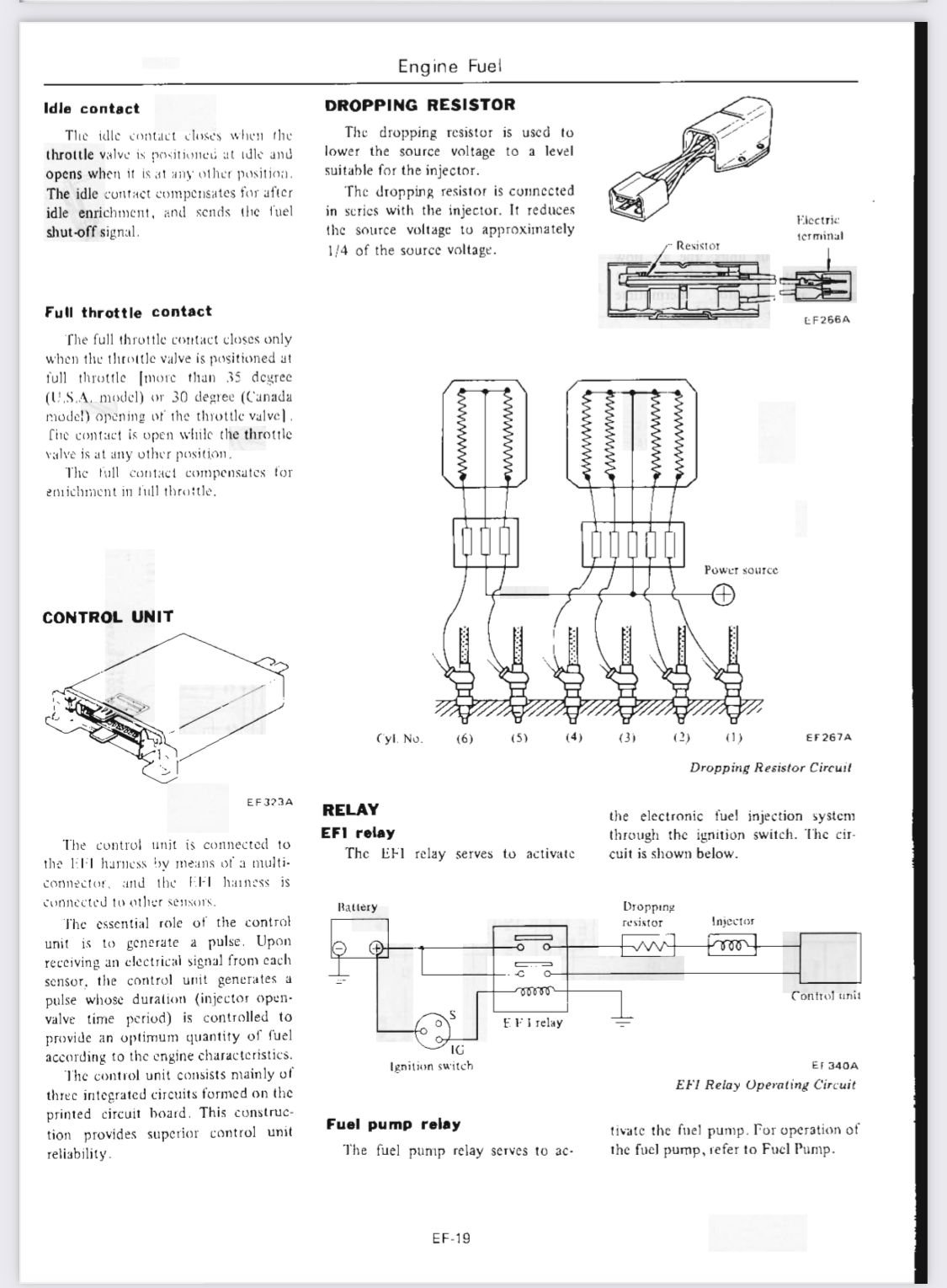

No, the dropping resistor limits the amount of current that the injectors draw. Resistors do not drop voltage across them, just limit the current flow. The 1975 to 1983 280z/zx injectors are low impedance injectors so they will draw too much current if it is not restricted by the resistors. Yes all of the injectors will have battery voltage on one side, you have to disconnect all 6 injectors at the same time to properly test this. The dropping resistor was removed in the 1982 and 1983 cars because the ECU was modified to handle the job of the dropping resistors. You can mix and match injectors in all years but the 1982/83 ECU cant be used in 79-81 cars and the 79-81 ECU cant be used in the 82-83 cars

if what your saying is correct why on page 19 of the FSM does it say drop resistors drop voltage from source to a quarter of the voltage?

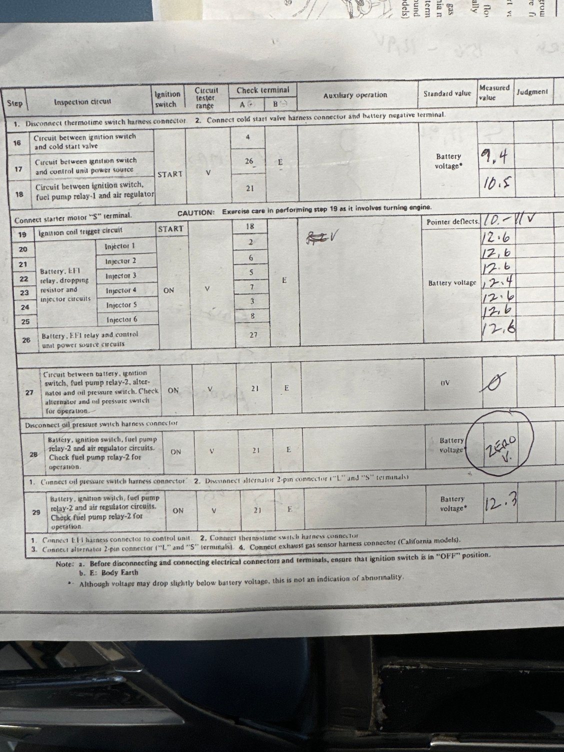

I have tested voltage at all injectors one side wire is at 12.6 on all 6 and the other side is zero on all 6 with key on

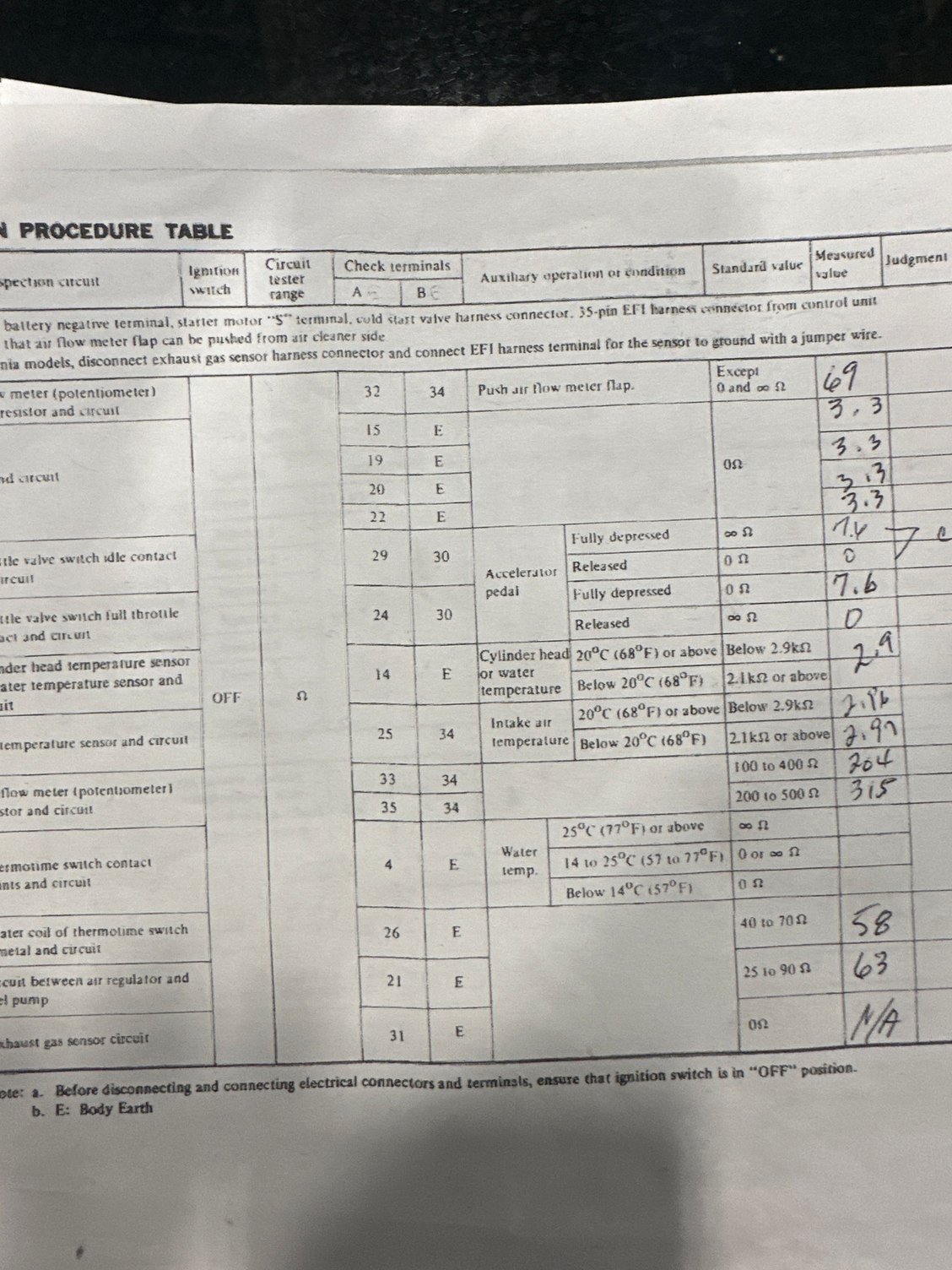

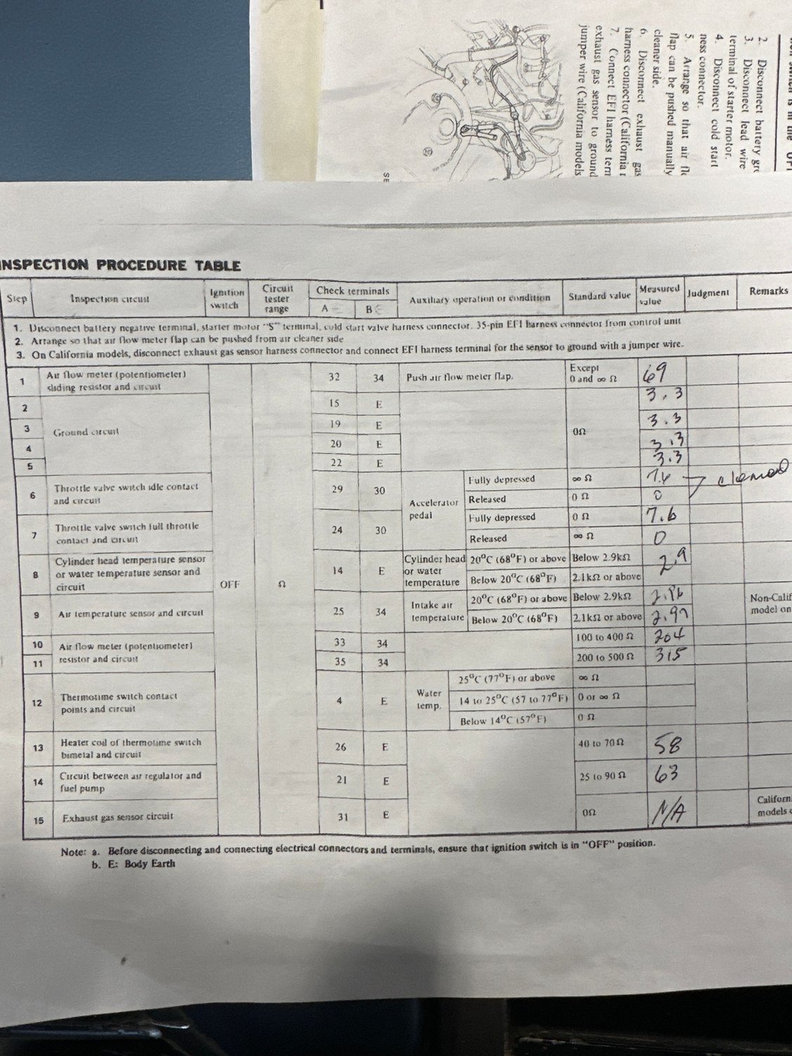

have went through entire FSM test sheets all checked to spec

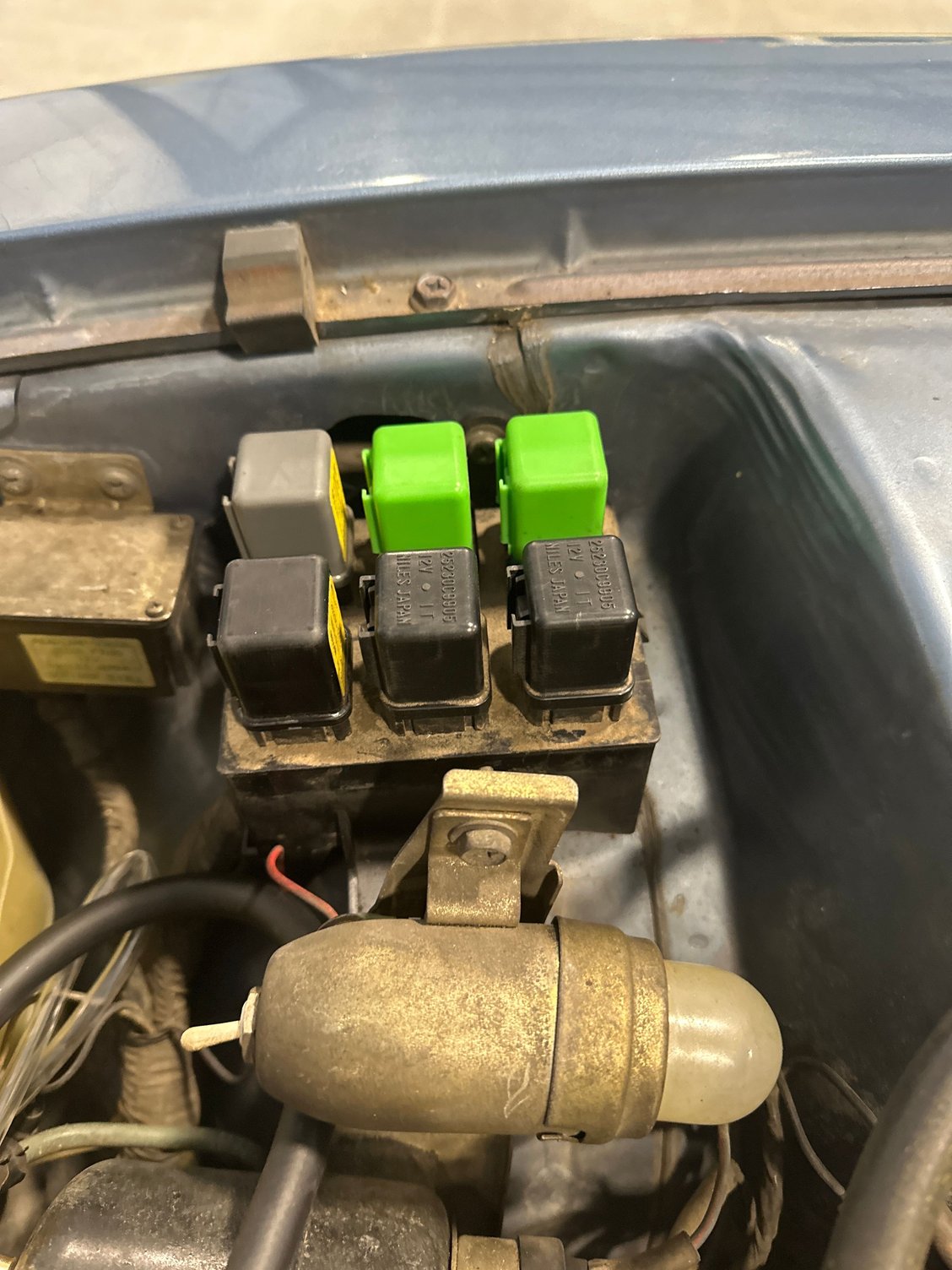

I did find an issue at 28 could that cause all this
fuel 2 relays
in this car there is two

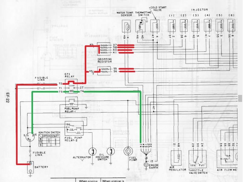

That's not right. Your ECU does not supply power to the injectors or the EFI relay, your ignition switch powers the EFI relay and that relay sends 12V to the injectors. Has someone messed with the wire system on the car?
I am starting to think that your ECU is bad. Figure out why you dont have power to the injectors with the ECU disconnected, that will be the key to figuring this out.
If you can get 12v to the injectors with the ECU disconnected and the injectors stay closed you don't have a bad ground wire on the injectors. If the injectors re-open once you reconnect the ECU I would say the ECU is bad.
Here is the wire diagram for the power to injectors
