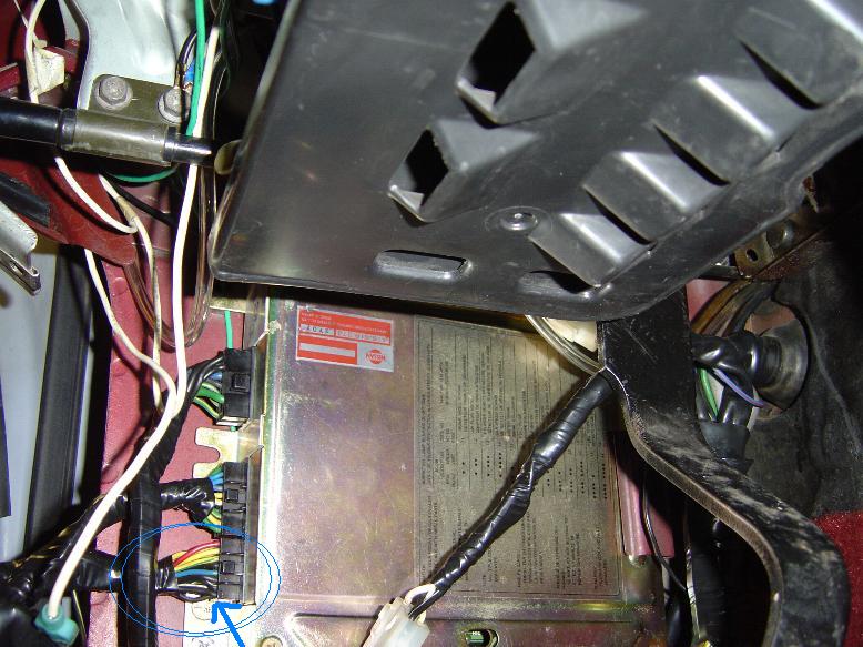

Also... your "ecu shake and runs better" sounds like a ground problem I have come across. On the 280zx turbos, the lowest ecu plug, lowest wires (2 or 3 black) join together about 2 inches into the wiring harness by a really crappy coupler. I found this because my Z as well (after doing the Z31T ecu swap) would idle really crappy. After hours of trouble shooting I narrowed it down to touching the ecu wiring, then to those bottom wires. That coupler was corroded and the wires were frayed. I chopped it out and soldered the ground wires back together. No idle probs since.

Anyway, I think what was the lowest plug became the top most plug on the Z31 setup, with the way the ECU is mounted so it lines up with the bolt holes. Anyway that splice is located inside the cabin then? Or would that be outside the cabin where that splice is? I think I remember looking for that coupler before and not finding it, but this would be for the two ground wires that are grounded on the intake manifold, correct?
See attached pic... the wires join together about 2 inches into the harness from the ecu plug (maybe 2 to 5 inches). It's a crunch coupler (or it was on my harness & my spare turbo harness).

I was poking around my wiring harness looking for that connector. I believe I found it, I just need a warmer day to mess with it more, but anyway it looks like two solid black wires and they both go into something, but it's covered by some kind of wrapping? Does this sound familiar, or sound like where the crush connector was? Some kind of material surrounds the two wires where they meet up and continues on for a while and inside of this wrapping feels like there's only one wire.
Old Mar 10, 2008 | 06:24 AM
Yep... that "wrapping" should be the electric tape. Remove it (you will want to wrap it w/ new e-tape when you put it back together).

Yeah I'm lazy on this one, but this is odd. I finally decided today that I would stop beating around the bush and go fix that ground wiring on the ECU that nismo clued me in on. Well after doing that my car seems to start up smoother, my A/F gauge seems like it starts reading quicker, and my idiot lights stopped coming on. This is weird, but I guess it's quite possible that a faulty ground in the ECU could cause the problem?
