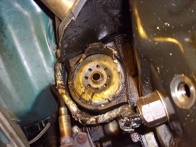

This morning I decided before putting it all back together I would also change the oil. The car hadn't reached the deadline but I believe it has been about a year or so since the last oil change. I'm semi glad I did. The synthetic oil was pitch black and the crush washer on the drain plug was coroding to to the point there was a break in the washer. Now comes the crappy part. The damn oil filter!!! The shop who last changed the oil must have the fraking hulk tightening the damn things. I tried absolutely everything from filter wrenches, leather belts, punching through a screwdriver to try to turn it (which just ended up tearing the filter around). Eventually I attempted punching a crowbar through the filter with the help of a sledgehammer which had the same effect as the screwdriver when turned. At the end of this all out attack I was left basically with what you see below (this photo is of another person with this problem on their car but it looks exactly the same. I promise I was turning the filter the right way- counterclockwise. I have no idea how the hell I am going to get it off. Has anybody else had a similar situation? My next option would be to call up my mechanic and see if he can help me out. Maybe an acetylene torch could melt it off haha. Thanks!

. So if anybody cares heres a brief recent service history of all the things that I've done and had done over the course of my drivership. By the way I did get that pesky oil filter off
all it took was a good PB blasting and some curved end needle nose pliers.
