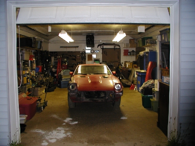

I'm still in the process of acquiring mine. It'll be my 2nd project car, but one that my wife has no input on (unlike 'her' 65 mustang that I've restored). Can't complain, it's practically free. Just gotta get an engine and transmission in it. Hopefully by June I'll be making a trip to pick it up. Already been out to see it and haul some engines back to rebuild for a both projects. Rust free, just needs some TLC though I did promise the wife I wouldn't spend much time on it until I got the 65 completely done.
I'm still debating which way I'm going on the engine.

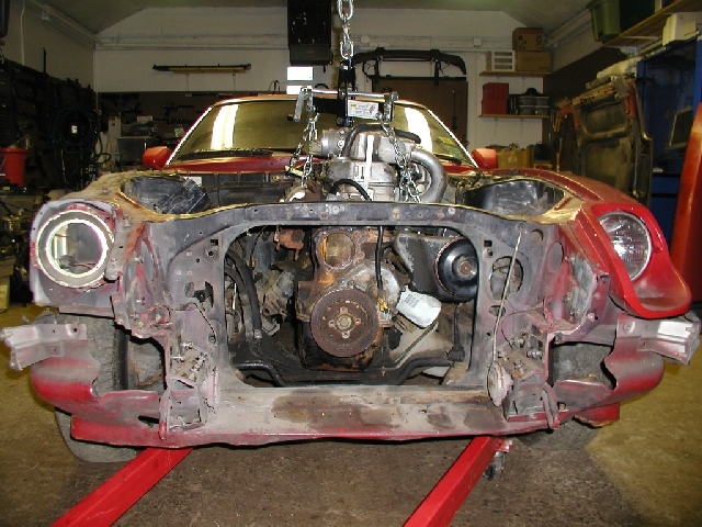

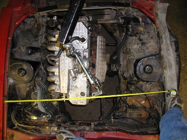

The other option (which is in my garage right now, getting rebuilt) is the one you see in the pictures. It's a Ford of Australia creation. It's a 4.1L I6. Now ford made a 4.1L for the US market, but it is a log head with a 1V carb. The beast in that picture is a MPFI, crossflow alloy head, with a stock BHP (rated, not gross) of 180HP. It has options for a variable runner length intake manifold as well (from the 4.0L down in australia). Its almost identical in dimensions to the L28, and is about the same weight. It will also made for a T5 transmission, so that won't be an issue. Problem is finding a rear sump oil pan. But, it's a torquey little engine. If that goes in there, it'll get a turbo as well. We did a lot of preliminary mock ups and measurements, and it would be a nice fit. Plus, I love the look of the engine. It's beautiful IMO. The height in the last picture is due to the engine sitting on the oil pan on the crossmember.
I thought about putting this engine into my current 65 mustang, but I'm in the process of building a SEFI system for it (it also has a unique australian head and intake manifold but on a US 3.3L block) and don't really want to scrap that project at this stage due to a number of reasons.
Both of those would be driven by MS3x (for SEFI and Coil on Plug).
But while I was looking at the 4.1L swap, I figured if I was going through the work, I might as well just shoehorn an LS1 in there. The thought of a 5.0 also crossed my mind.
However, I love inline engines. So I'm back to thinking about the 2.8 and the 4.1. I just have to inquire to Australia about rear sump oil pans (which they have). This engine is one of the holy grails for the ford inline enthusiasts here in the states. I also got this engine for free.
So, keeping in mind my budget weekend track fun car, leaning heavily towards the two inlines.

Sounds like you're a prime candiated for the L28ET then. The 4.1 is giving you the same HP as the stock L28ET which is doable for about 300 rwhp with the stock bottom end especially if you are already looking down the MSIII path. It's a simple swap - it was built to go into the car and support and other resources are plentiful.
Yeah, I've started looking for a L28ET. If I put the 4.1 in, I'd put some forced air in it. But then I'm at the limits of other parts of the car, particularly the rear end. I also don't know that I need more than 300 RWHP.
