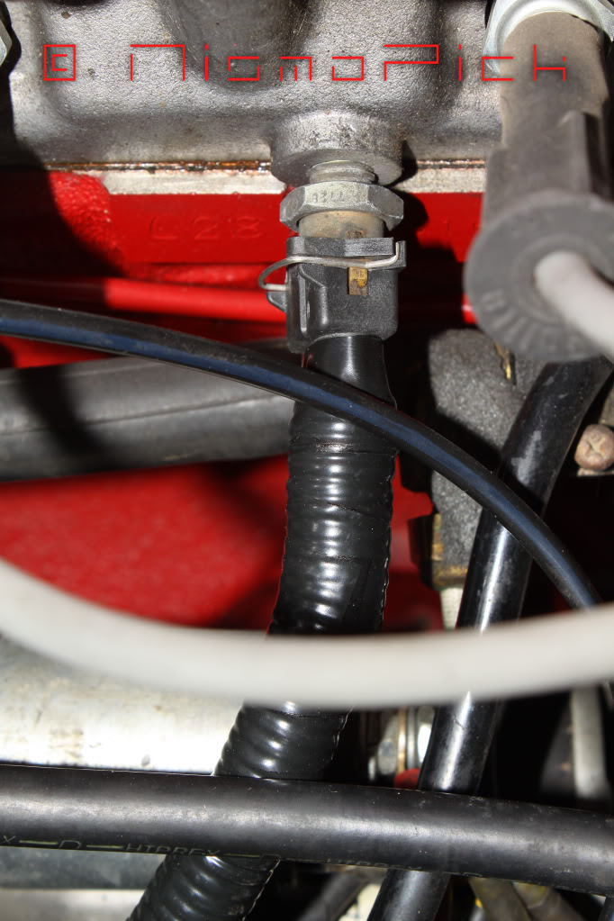

Between Cylinders 5 and 6, check that, unplug the connector and check the leads. (Sorry for quality)
This is a very common culprit for the issue that you are having.

where can i find the connector going into the chts. ???what is it called?
CHTS connector, I think...
It's that Yellow-GreenStripe/black wire, I think mine might be spliced/soldered (PO was retard)
Chillin next to the dipstick and spark plugs 5 & 6
Right above your engine badge
0508112017.jpg?t=1304904092
0508112017a.jpg?t=1304904093
where can i purchase the connector. not the CHTS but the plug in . what is that connector called ?
It is pretty much like a fuel injector connector. So just get one for that, wire it up, and you should be good with that.
Yup yup... https://www.zdriver.com/forums/showt...ghlight=MAXIMA
The plug is called an EV-1 or a Bosch EV-1....
