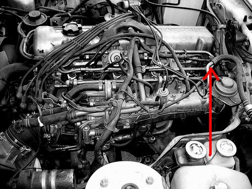

The bolt that is broken off is last one on the engine twards the driver end. I don't know how the heck I am going to get to it with out pulling a ton of crap off of the motor.

that's pretty much the only one that breaks. You have to remove the intake and exhaust manifold. It's kind of a pain, but once you know how to do it it's not too bad. Go check Shady's writeup on doing the intake/exhaust gasket.

the front one (opposite to the one you see broken off) is probably broken off too... its covered up by the thermostat housing

I'm going to say the stud under the thermostat housing is probably fine. It seems like only the last one ever seems to break.
