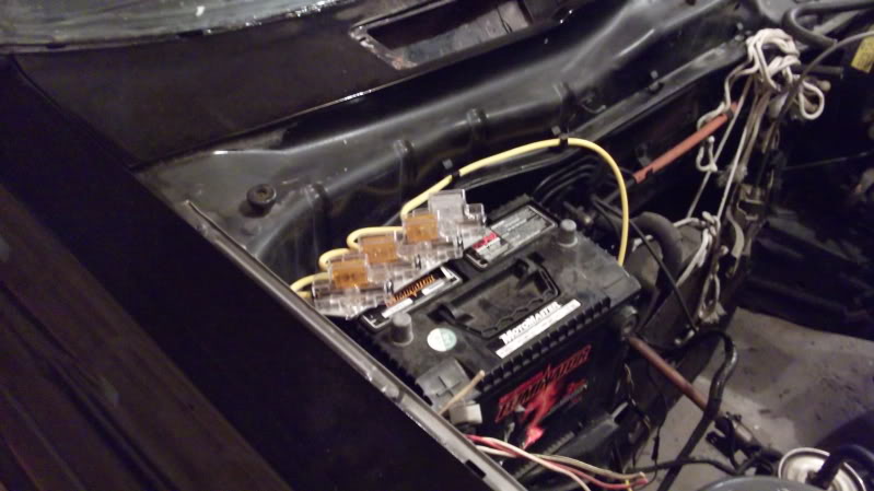

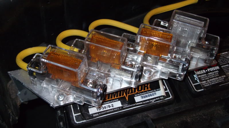

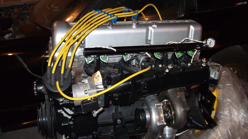

BUT, I went out and ordered a starter, and totally forgot to get an oil pump, so ordered that bad boy too. I looked everywhere for fuse blocks, I swear when you ask someone they get a blank stare. So I went to wallmart and bought individual ones, bolted them and wired them in, just gotta finish wiring to the car now. Threw the alternator on and engine mounts, and some coolant fittings, gotta drill and tap the thermostat housing to fit the GM temp sensor.
Tomorrow I am going to rent an engine hoist and attempt to throw this thing back in. Then start the wiring and getting the MS running and other odds and ends while i wait for starter and the oil pump.
some pics
fusible links to maxi fuse.

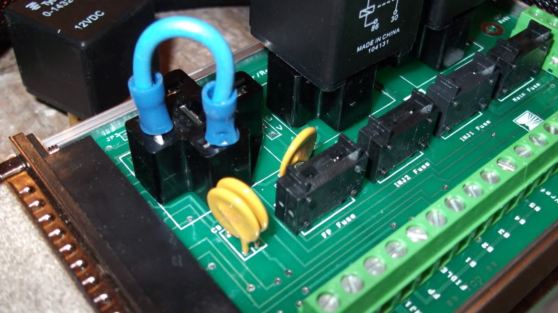

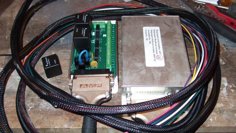

MS and wiring harness and relay
jumper for FIDLE to IGN trigger.

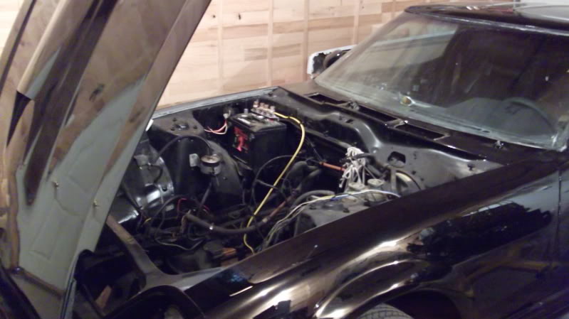

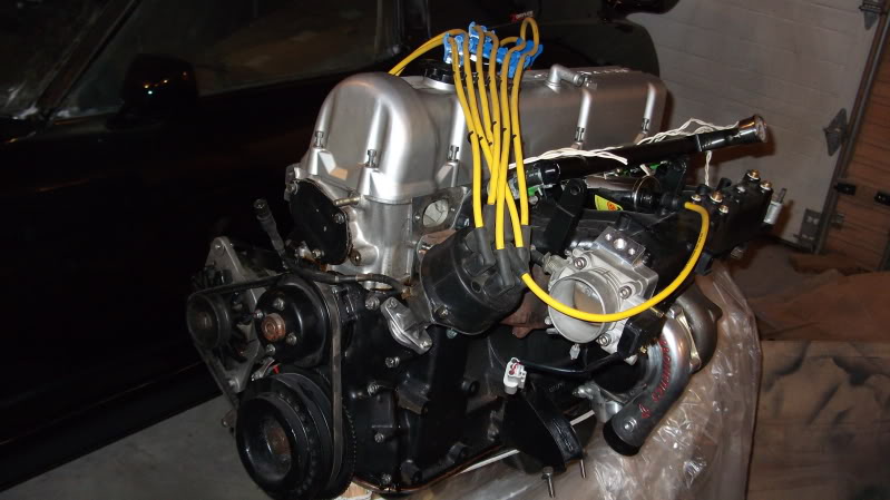

Few more things to go on, but I can do that while its in the engine bay, screw it.
ANd tomorrow hopefully IN THERE!!!
