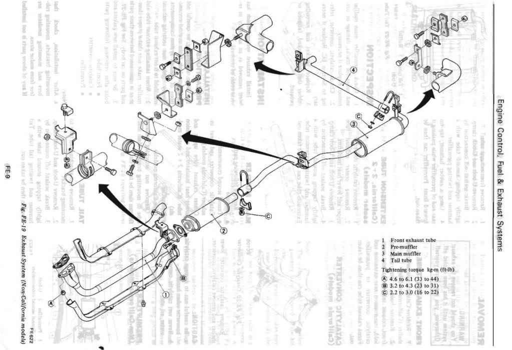

I was just looking in the 1979 280zx FSM and found that datsun made a 280zx without a catalytic converter out of the factory, and I doubt they would have released a car with such an obvious problem as an exhaust leak.Name:  Capture.jpg
there's a "pre-muffler" where the cat should be, I have a 79 280zx with a factory exhaust, no cat and holes in the muffler, and no exhaust fumes get into my cabin, you must have a leak somewhere, look all around and inside the car, check the power antenna drain, maybe its coming in through where the e-brake cable goes. an easy way to test for major exhaust leaks is to just cover the exhaust pipe with your hand(while it's cold) and feel for the exhaust to push your hand away.
