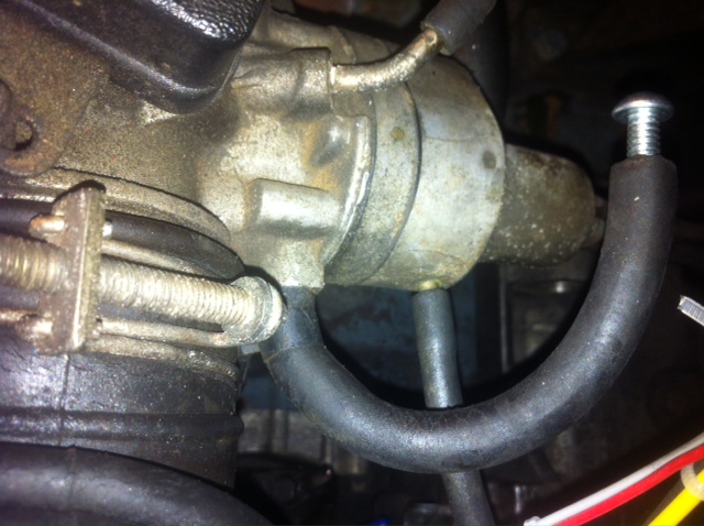

Here's the part I'm referring to, it is mounted directly underneath the auxilliary air valve. You can see the three small hard lines coming out of it on the far side, and one of two small coolant hoses that lead to it on the front side.

Old Nov 12, 2012 | 08:17 PM
Yep... you can get rid of it as long as you cap the other ends at the throttle body. Also, where is your distributor getting it's vacuum advance signal?

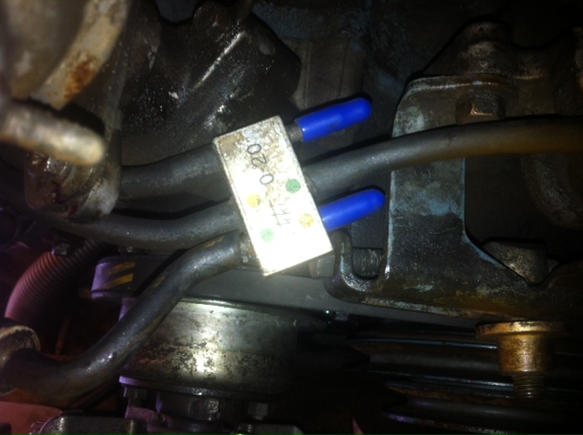

I'm continuing to clean up the intake area and all of the various vacuum lines (some of which have been removed by the PO.) As yet, I've been unable to find a complete diagram of all the vacuum lines, similar to a wiring diagram I suppose. As such, I've got a couple of areas of confusion. First, there are three vacuum lines which lead into the Thermo Time Switch. These lines then go down to a three pronged bypass, and on mine, two of the three lines were already not in use (show here with blue caps on them.) Is the TTS even functioning properly with only one of the three ports active?? I'm tempted just to yank it, but need to understand better if removing it will leave the cold start valve overly active, or if it will completely disable it.
Secondly, I have no vacuum line running from the distributor to the TB, the port on the distributor is just sitting open right now, so presumably the vacuum advance is not working. I know this needs to hook up to the TB, but there are SO MANY non currently used ports on my TB I don't know which one I should be hooking it up to. Does it even matter, or will they all function identically?

Maybe it's been too long since I've worked on an N/A, but there shouldn't be any vacuum lines going to the thermotime switch... You are talking about the two prong sensor in the thermostat housing? Pics?

Thanks NismoPick. As you may well have figured out, I'm new to this generation of cars, so my apologies for my ignorance. It appears that I was incorrect in the naming of the part I'm referring to, it is in fact that Thermal Valve Vacuum directly below the thermostat housing that I'm working with. And, now that I've got the correct name, I've been able to find some images in the FSM that match what I'm seeing (I have the D2 Type, and then D1 Type from on top of the manifold has already been removed.) So, here's my question: Only one of the three lines coming from the D2 TVV is not plugged, and it's running into the triple nipple vacuum collector pictured in my previous post. This vacuum line runs directly to the bottom of the TB, NOT the vacuum collector on the side of the Distributor that the FSM shows with a secondary lead going to the now-gone D1 type on the manifold. To see what would happen, I moved this line over to the vacuum collector on the Distributor (which has just been sitting open for as long as I've known the car) and it raised the idle way up, probably by 600rpm or so.
Given that these two TVV's appear to be linked originally, and one is already removed, and that two of the lines leading to my remaining one are capped, my inclination is just to do away with it altogether as it's hard to imagine it is still performing its designed task. If I understand correctly, this system is most active while the engine is cold and at lower rpms, something this car just about never experiences. Do you see any reason why I can't just remove this entire system? And, if I do, should I simply cap the line on the bottom of the TB that the TVV lead is currently leading to? Secondly, do you have an illustration as to which nipple on the TB should connect a vacuum line to the vacuum collector on the distributor?
